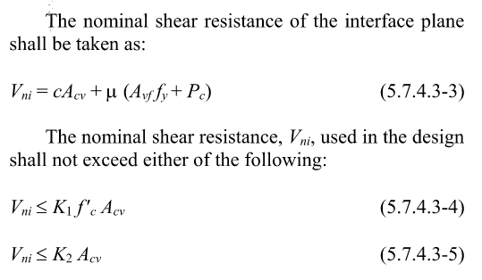

I'm not very familiar with ACI but AASHTO has this equation for interface shear capacity. You can omit the reinforcement term. They do also have a requirement in the previous section for minimum reinforcement crossing the interface, but it is mainly written about girder/slab interfaces. It doesn't say that the interface capacity equation is invalid unless you meet that requirement.
Eurocode 2 has essentially the same equation as AASHTO, and they don't have a minimum interface reinforcement requirement as far as I am aware.

There are a couple of paragraphs in EC2 a bit further after the formula. If the interface is cracked then c*fctd=0. If no external normal force is presented across the interface that can act simultaneously with the shear force then μ*σn=0. Then only reinforcement remains.
Agreed about the normal force term. But for c*fctd, the language is "if the joint can be significantly cracked." I interpret that that if you can prove that service limit state checks are satisfied, then cracking will remain within allowable limits - i.e. not "significantly"

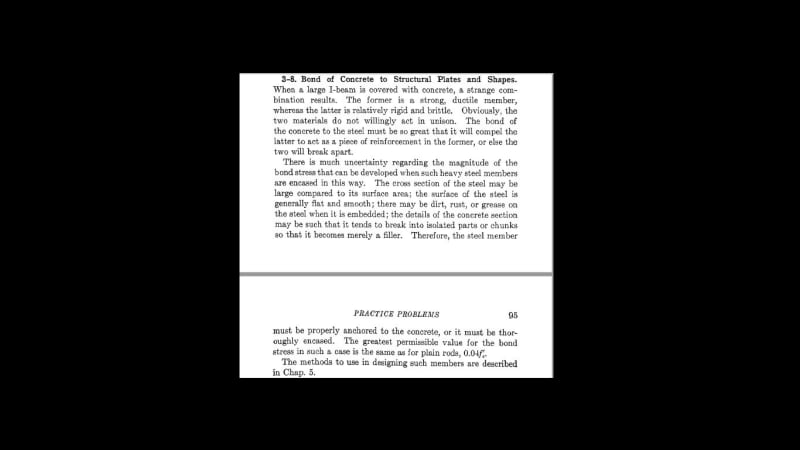

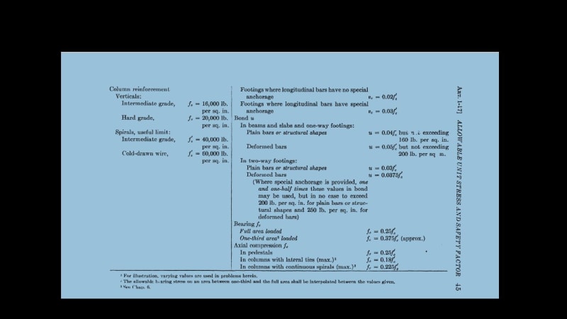

- I looked an old book (Clarence DUNHAM ,THE THEORY OF REINFORCED CONCRETE , 1944 ed.) The allowable bond stress for steel plates , structural shape = 0.04 Fc
- More than 20 yrs ago i have encountered a very similar case and with engineering judgement , i proposed to use 15 psi but the consultant ask test . A few tests conducted at an univerity lab, the scholar proposed upper limit 18 psi .
