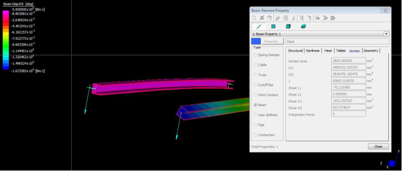

Not sure exactly what your are doing - in FEA if the point tip-load is applied on the shear centre (SC), then we would not see any twist.
Below is an example of a c-section beam element with load on the centroid (right beam below), where twist is seen (as expected), and one that has the load applied on the SC via a RBE2 element (left beam below), and as expected there is no twist. The RBE2 equivalent in abaqus is coupling of kinematic type or *kinematic coupling. Or even easier like in Strand7 where a rigid link (RBE2) is used, a rigid element in abaqus called RB3D2 can be added in the same way as in the Strand7 model above (just between the end-node of the beam and another node on the SC). With this method, the same results are seen in abaqus as below, with of course no twist of the section.
I must say though it is much easier for me to visualise the twist, render stresses in 3D on the section, and also run both material and geom. nonlinear analysis (do not think it is possible in abaqus with a meshed section) of a user defined beam sections (beam general section of mesh type in abaqus) in Strand7 than in abaqus. There is a free demo version of Strand7 should you want to try that out.

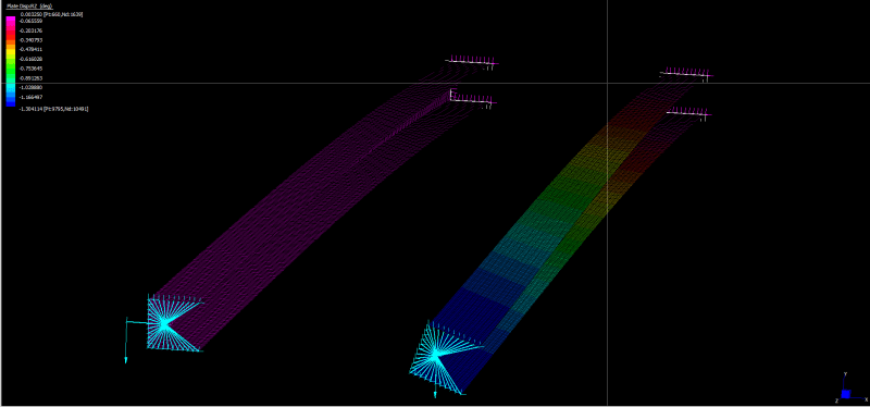

Ok, thought you talked about beam elements - the same thing applies for shell or plate elements - that is if force is at SC then no twist (see image below - left beam has force at SC, right has it at the centroid).
Sure, it depends what you want to do - so for a local model, looking say for local buckling of the section (say web buckling), one would use shells.
On the other hand if you have 100 or 1000 of members, (say doing a global model large stair case, according say to EC3 standard), one would of course then use beam elements, get forces/moments and check against allowable capacities defined by the code. So global large models use perhaps beams, local models (say looking for local buckling, or other funny stuff, e.g., like local plasticity/yield on a one off section or connection), use shells.
