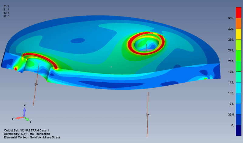

I am trying to calculate a flat shaft cover, mounted with several bolts.
These are the dimensions (in metric system):
shaftØ140mm
cover outer D=160mm
thickness=12mm
bolt= M16 (3x), hole Ø18mm, pretension bolts is 640*70%MPa.
PCD=Ø110mm
First I tried doing this with the use of Roark formulas for stress and strain (Chapter 11, case 9a).
The results was a bendingstress at the centre of the plate of about 395 MPa.
For some reason, i wasn't expecting this high stresses, so i did a FEM analysis.
Pivot support, 3x 70300N (pre)tension.
With the following results: Maximum stress at centre plate about 150MPa.
This is indeed a huge difference.
I was assuming that using the uniform load of roark was a good idea, but maybe it was not.
Unfortunately i haven't found any other useful calculation to calculate the stress in a shaft cover (with holes).
Can anybody help me finding this?
Thanks!

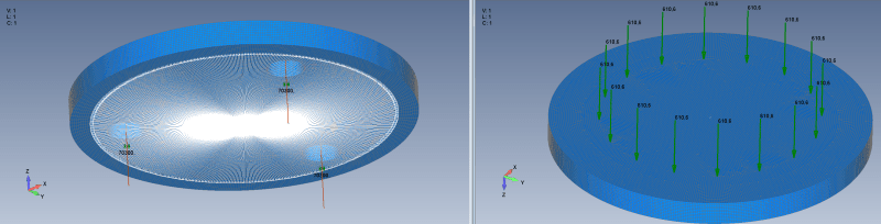

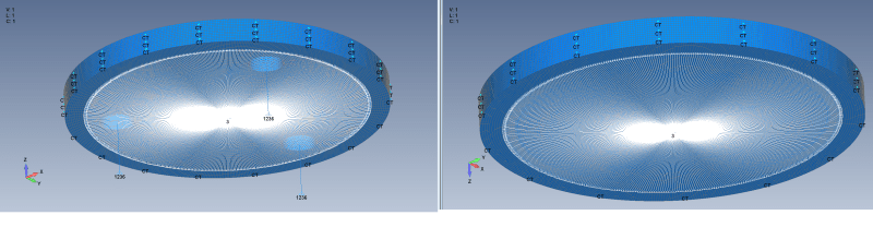

My first intention was not to give the full report about how I modelled this shaft cover, but since you are both asking for it...
Solid mesh, very, very small elements (1x1x1mm) Why solid mesh? Because this might be a model where shell mesh would not be very correct.
I have done two analysis.
1) shaft cover with bolts
2) shaft cover without holes (to check Roark)
The support in both cases is a line support in only Z (3) at Ø140mm. (with a spider)
The thickness surface of the shaft is constraint with Femaps "Cylinder/Hole""Constrain rotation around axis" (CT). So radial growth or shrink is possible.
In case 1) the bolts are constraint against translation (1,2,3) and rotation around shaft (6)
Unfortunately, the coordinate system is mirrored.
Left is case 1), right case 2)

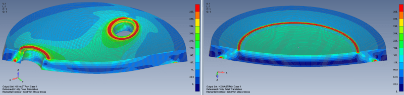

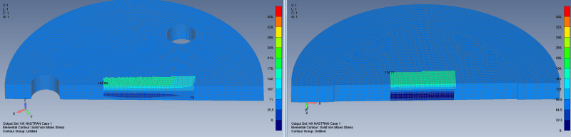

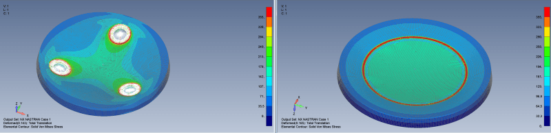

Despite of the fact that case 1) has holes, and case 2) not. The stresses are comparable (165MPa vs 175MPa), at least compared with the high stress calculated with Roark (395MPa)
So with or without holes... i neglect this difference. I noticed that the centre line of bending was not in the centre of the plate.
I am still wondering why Roark gives such a high stress, while my FEM model shows an acceptable stress level. Roark says: "the thickness is not more than about one quarter of the least transverse dimension, and the maximum deflection is not more than about one-half the thickness", so in my case Roark should be applicable.
So I did another test. Plate diameter=2000mm, load diameter=1300mm, thickness=12mm, load=211000N (=211000/(1300*PI)=51.66N/mm)
Stress in FEM=533.23MPa, Stress according Roark=533.21MPa. Perfect correct. and bending line is exact in the middle of the plate.
I suspect that length/thickness ratio plays a part here, and that my case the thickness is too high to be correct.
