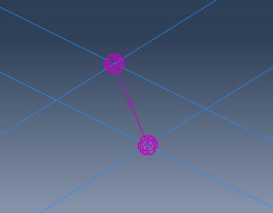

Could you please tell me how to get such type of connection?
Thanks!
