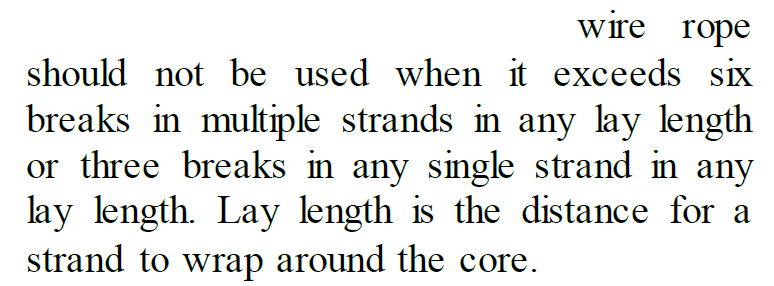

The outer strands of wire rope are the most highly stressed. Sections of wire rope should be routinely cleaned for visual inspection to look for breaks:
See: US Department of Labor (OSHA) "Working Safely With Wire Rope".
