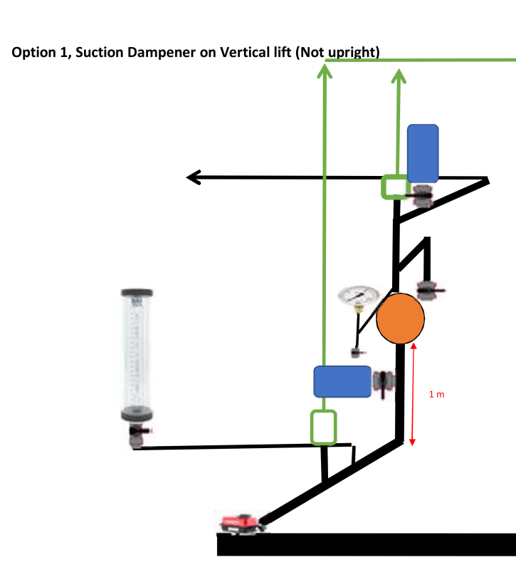

Hi i read about sentry pulsation dampener and inlet stabilizer.
I would like to know if the suction and discharge dampener can be installed in this configuration.

What is the riser or dead end referring ?
4 Types of Installations
i believe it would be end of piping without any connection or equipment.
Your option #3 is the best piping arrangement.
[link bmw318be (Mechanical) ]The pulsation dampener should be installed as close as possible to the pump discharge and further away than 10 pipe diameters.[/url]
You left out the word "no". The pulsation dampener should be installed as close as possible to the pump discharge and no further away than 10 pipe diameters.

Hi Bimr,
Thanks for your illustration, is the dead leg create more pulsation and hoe this couod be favourable in the hydraukic metering pump dampener installation.
Is option 2 and 4 is considered a dead leg as there would be one way flow and return due to dead leg.
I was advised by manufacturer for suction dampener that installation 1 is dead leg and some other manufacturer considered installation 1 is the closest to the pump and favourable.
Any opinion on the schemantic attached
Yes, options #2 and #4 may be considered deadlegs. #4 is definitely more of a deadleg than #2.
The schematic in your post doesn't show schematic #1.
Dear Bimr,
Thanks for your input, I added the illustration of
Schematic 1 (I believe this not recommended)

I would not expect that either suction or discharge dampers (type as shown) would have any affect on debris collecting or removal in dead-leg pipes, since they are not in the flow stream. Dead-leg location and length can affect pipe acoustics (pulsations), but that topic is beyond this discussion.
Walt
There is not much difference between #1 and #3 schematic and I would not expect much difference in actual operation.
I don't expect that either suction or discharge dampers would have any affect on debris collecting or removal in dead-leg pipes. In addition, for your application, the amount of sediment will be nil.
I would not expect any unbalanced flow either.
Your system is relatively small. With large systems and high flows, it is more important to address the issues that you are bringing up. With smaller systems, the effects are less important and may be ignored.
If you follow the general design guidelines put out by the manufacturers, you should not have any problems. The problems occur when people read the directions after they have everything is installed.
Dear Bimr,
The pipe is a PVC pipe, pumping a water with small concentration of chlorine 1%, may I get your opinion on another possible option 5 as Option 3 is not feasible due to space constraint and maintainability of the pump head. Therefore, I would like to consider a straight elbow of 10 pipe diameter 2" and straight elbow back to the suction header of 6"
Link
The option #5 schematic would be an acceptable design.
