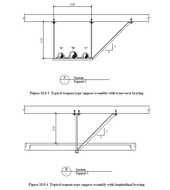

I don't generally view "hangers" as part of the lateral force resisting system. Certainly in the hospital work that I've done, we're required to put in a series of diagonal cables to take ALL of the lateral force. I can't imagine designing something that weighs 1000 lbs on hangers without some bracing or cables to take the lateral load.

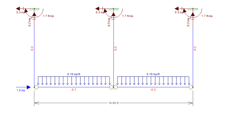

Here you go John.
Lateral load is at 1000 lbs but you get the idea.
@CDLD
great, expert of model!
Can you also model it upside down, with 2 beams on top, 3 columns fix on bottom? I bet you get 0.33 kips each, but as I know, usually for portal frame, middle column takes 0.5 kips.

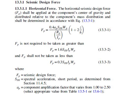

I assume ASCE 7-16 Section 13.3 ( SEISMIC DEMANDS ON NONSTRUCTURAL COMPONENTS ) is applicable .
If the max . force is more than 5 times of minimum, and the calculation is based on a lot of assumptions , i would go with max . force.
But don't forget to provide bracings ( transversal and longitudinal ) since the seismic force will be resisted by bracings not hangers.
