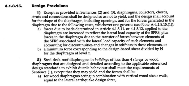

2) Where are you getting the term [Fpx] from? That means something specific in the US codes but, to my knowledge, is not part of the NBCC procedure (shown below).

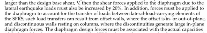

3) In general you use the [Fx] values for each floor amplified for capacity design for diaphragm design and not the total story shear at a given level. Do keep in mind that there are situations where diaphragms are called upon to pass significant loads among themselves and loads may be much higher than the [Fx] values as a result. See the NBCC commentary section below for some specific examples of this.
4) Be aware of the alternate procedures available for wood and steel diaphragms in low rise buildings for which inelastic diaphragm behavior is permitted.
