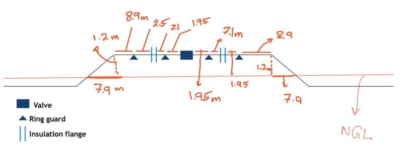

I'm currently facing a challenging situation with a new pipeline project involving a valve station where we need to replace a gasket. Despite loosening all flange bolts, we have not been able to achieve the required gap for a proper gasket replacement.
Project Overview:
The valve station's design necessitates a specific gap for gasket replacement. To address this, we've excavated approximately 50 meters around the area to create sufficient working space and facilitate the process.
Current Equipment and Setup:
Lifting Equipment: We have employed a sideboom to lift the pipe. However, it appears that a single sideboom does not provide sufficient lift to achieve the necessary gap.
Flange Spreaders: We are equipped with 7 flange spreaders, each with a capacity of 14 tons, but even these powerful tools have not sufficed to open the flange to the required extent.
Challenges Encountered:
Insufficient Lift: The primary issue is the inadequate lift from the sideboom, which is critical for achieving the required separation at the flange.
Flange Rigidity: Despite the high capacity of our flange spreaders, the rigidity of the flange assembly under the existing conditions has proven to be a significant barrier.

 https://files.engineering.com/getfile.aspx?folder=3ba16820-2c97-4cb2-a1d5-97fc4dd2d982&file=diagram_.jpg

Pipe Diameter, wall thickness and flange type.
Depth of pipeline.
Elbow details.
What is the temperature of the pipe now?
What was the installation temperature?
Have you thought about cooling the pipeline, or trying to do this during cooler hours of the night, or delaying the work entirely until winter temperatures arrive?
Cooling sounds like your only way option.
Liquid nitrogen or CO2 would do but try not to go below - 30.
If the pipeline is dead straight, axial forces could reach over 150 tonnes easily.
But not quite sure what your side boom is doing, but contraction is better than having to take a cutter to it....

the pipe size is 56"
thickness is 0.8 inch
material: Carbon steel
Grade: X70
to clarify these are not elbow bend, but field bend.
for the pipe temperature I do not have the exact temperature, but the weather temperature at day is around 45 C and at night it reach to 36 C.
for the activates, I do not think we could delay it to the winter time, but we are working at night when the temperature is lower. we were working good without issues, however, for this location we have faced this issue

What is the plan view of this valve and the 100m of pipeline either side?

Pipeline valve stations/pig stations typically face the problem you are facing. This is normal. This is due to transition of the pipeline from restrained to semi/unrestrained pipeline when the U/G pipeline transits to A/G.
LI and -44 has suggested to cool down the line to replace the gasket.
If you are using API 5L X70 Piping, the MDMT for the 0.80 inch thick line will be -8C with full line pressure. Obviously, you have isolated the line for maintenance with no pressure on the section. you can safely cool the section to -48C without any impact testing.
To avoid this situation of lock-up due to excessive thermal stress at the A/G portion, many Owners suggests to use a Z-bend at the transition instead of single S-bend. This is in addition to the virtual anchor point, the designers use at the transition.

Offset bends in 56" pipe would need very large dimensions to get any flexibility.
An offset like this one can cause very high bending moments from expansion forces, which can misalign flanges and destroy electrical isolation joints. It would probably have been better not to have put the valve above ground, so that bending moments are not created by the valve's vertical offset from the main pipeline centerline. Yes, even with flanged joints.
Best of all is to use weld end valves and place isolation joints or fittings somewhere else, well away from regions subject to high bending moments. Riser bends like these seem to be a favorite place to put flanges and isolation joints. I see these everywhere, but it is not good practice. It is typically the highest bending moment region in any pipeline.
