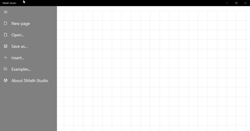

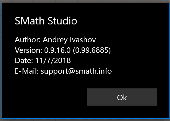

By the way, which version of SMath are you using? I tried the one from the Windows Store, but I found it lacked some menus that are found in some SMath videos.
My version:

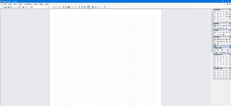

The version I see checking tutorial videos:

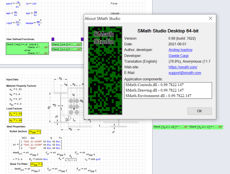

This one...
