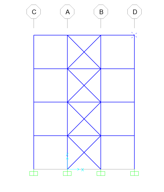

Hi there,
I am trying to calculate the deflection of a moment frame made up with a shear truss.
Each bay is 3 metres, so total height is 12 metres. I am using a static horizontal load of 10000 N/m.
I am modelling it as a cantilever beam using stiffness 'K' as (8*E*I)/L^4
I need to find the second moment area of the structure. For the shear truss alone I get the correct deflection. In the literature I have found that the second moment of area is 0.9*(2*(A*1.5^2)). A is the cross-sectional area of the column, 1.5 is the distance in metres from the neutral axis. Using this I get the correct answer. However, when I add unbraced bays to each side I do not.
I guessed that the new second moment area of the total structure is 0.9*(2*(A*1.5^2)) + 2*(A*4.5^2), but I don't get the correct answer from this.
So, Could somebody please tell me what the second moment of area for this structure is, please?
Best wishes
It doesn't really have a "second moment of the area" in the strict sense. The drift at the top is a function of many input parameters, including the types of connections between all of those members.
You could use the program to compute the drift at the top and back-calculate an "effective second moment of the area."
For example, apply P = 50 kips laterally at the top, and calculate the drift, Delta. Then use Delta = PL^3 / 3EI to back out Ieff. That's the closet thing to what you're asking.
