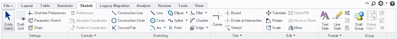

I opening an .dwg file in proe by converting to "layout". I want to move sketch to some place defined by coordinates. In proe wf5 there is a option "translate" as a child of option transform. Is there a similar option in creo parametric 2.0?

I have no option "edit". I am using Creo Parametric. There is no option edit on ribbon.
Under the sketch tab there is an edit ribbon with the translate button in it.
Sorry, I was out of the office with no access to Creo on the road. It was under the edit menu pre-Creo.
It's the standard clipboard functions, in the 'Clipboard' area in your screen shot. Select the entity you want to move and the copy icon will be available. Paste special then puts you into translate mode.

Ok now I founded by your instructions, but only in drawing mode, why that command is not available i layout mode or sketch mode? Proe WF has that option i more than drawing mode.
