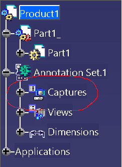

Hi all
I want to get a capture object Directly under a product by VBA.
There is a way which is using a search method for to get a capture object.
I want to know a way to get the object Without using a serch method.
Otherwise if each capture objects under a products can be searched by using
this script bellow, it is good as well.
The problem of this script is only to get a capture under selected product(ActiveDocument).
It is good to get a captures under a each products, not all at once like this "CATTPSSearch.CATTPSCapture,all".
Sub CATMain()
Dim productDocument1 As ProductDocument
Set productDocument1 = CATIA.ActiveDocument
Dim product1 As Product
Set product1 = productDocum ent1.Product
Dim products1 As Products
Set products1 = product1.Products
Call ExecuteRecursiveSearch(products1)
End Sub
Private Function ExecuteRecursiveSearch(ByVal products1 As Products)
Dim pro1 As Product
Dim partDocument1 As PartDocument
Dim selection1 As Selection
With pro1
For Each pro1 In products1
[highlight #CC0000]Set selection1 = pro1.Application.ActiveDocument.Selection[/highlight]
selection1.Search "CATTPSSearch.CATTPSCapture,in"
Debug.Print pro1.Name
Set prtDocument1 = pro1.ReferenceProduct.Parent
Set products2 = pro1.Products
Call ExecuteRecursiveSearch(products2)
Next pro1
End With
End Function
This is close my image but not working.
[highlight #CC0000]'Set selection1 = prs1.Application.Documents.Item(prs1.ReferenceProduct.Parent.Name).Selection[/highlight]

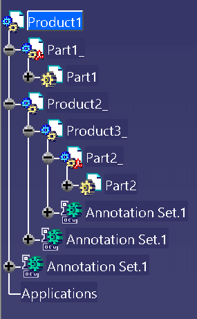

I dont't want to search all components like "Captures" under selected product.
Example, many products linkes in a tree like "product[A]---Product---Product[C]"(the sample picture attatched is wrong becase of only one product)
※[A] is parent,,[C] are a children.
If I slect [A] by using "sel",maybe and [C] could be selected.
In this case , I want to get the capture under the [A], And next under the , also next under the [C] along the script I put.
If there is a way to get Capture object without using search method, It is the Best.
regards

This is more real on my situation
This is my verification about using GetTechnologicalObject bellow.
1. If I selected the ptroduct1(Active) and did GetTechnologicalObject, All AnnotationSets are retrieved
2. If selected the product2(Active), AnnotationSets under the Product2 are retrieved.
It looks like a specification to retrieved an AnnotationSets under the ActiveDocument.
Based on this situation, I want to select the ptroduct1 and Process each product to retrieved their annotationset in order by vba.
If you have a solution, I want a sample script.
