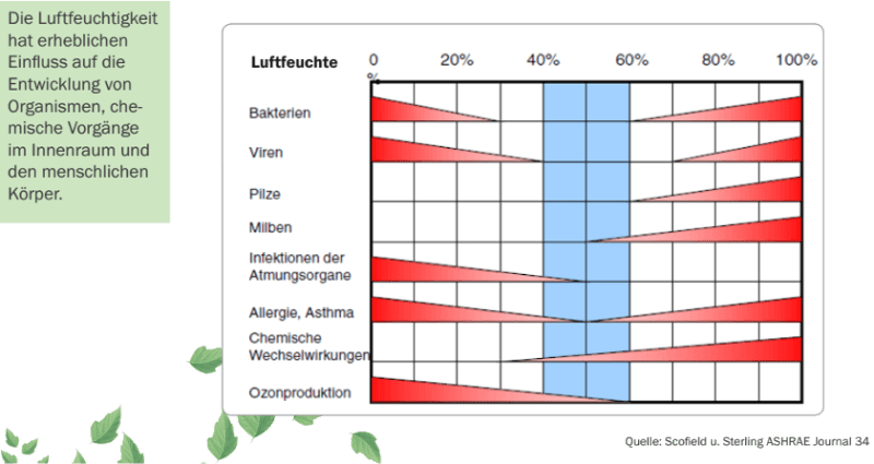

I found the following picture yesterday when i was searching the web..
Seems 45% is the optimum..So , keep the relative humidity around 45% and get free from chemical corrosion, viruses, bacteria ..etc. etc..[2thumbsup]
