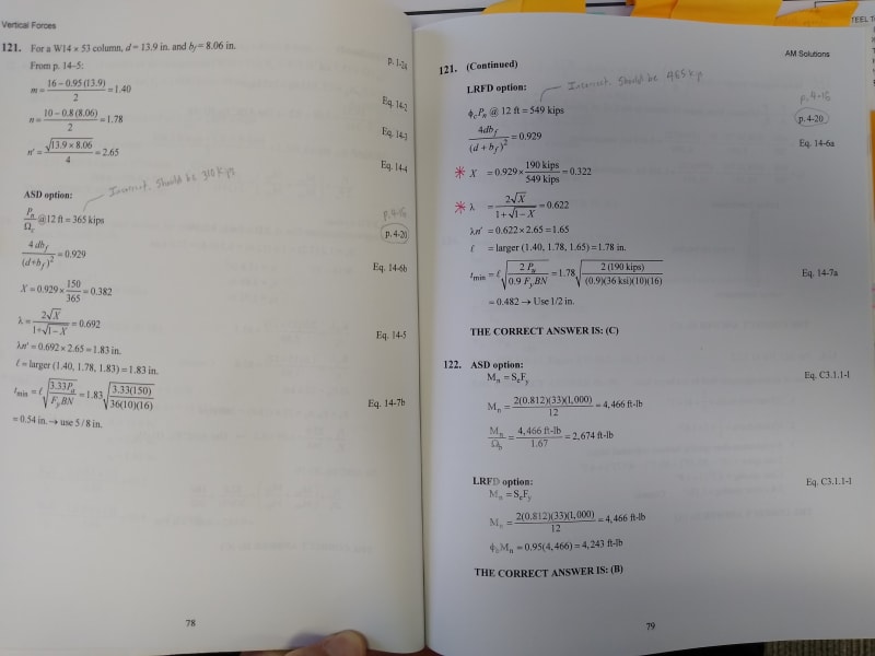

1. I was working a practice exam for the upcoming SE and had a question about the base plate design problem (AM Vertical; Problem 121)
First, NCEES did not provide the column section in the problem statement, but that is a QA issue. My question is in the solution. Did they omit the 'omega' factor for computing "X"? It seems that a 2.31 factor is missing and this would seem to blow the problem up.

I have the 2011 version of NCEES sample questions and it states a W14x53 column (see snip below). I am sure this is older than your version, but it is odd that Q121 is still a base plate design problem. If nothing else, this will give you another sample problem to work.

Thanks RW. I have a 2011 version as well and that problem was straight forward. BUT the solution for that one (2011) did NOT use the concrete check, rather the allowable column load. The 2017 edition uses the allowable bearing stress as the limiting value for computing X.
I did find the "Errata" where they provide the column section in the problem statement.
But there was no correction for the "Omega" factor in the solution. What am I missing?
Yes, it does appear that the ASD solution is missing the omega factor (which should be 2.5). If it had been used the X value should be 0.854 which would result in a lambda value of 1.33.
However lambda can not be taken greater than 1 and can conservatively be assumed to = 1. So, this error does not change the overall result of the problem, where they (not so conservatively as they thought) used lambda equal to 1 to calculate lambda n prime.
