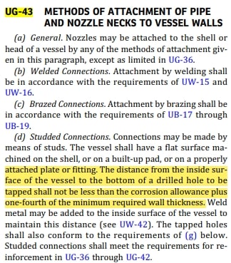

UG-43 may be helpful.

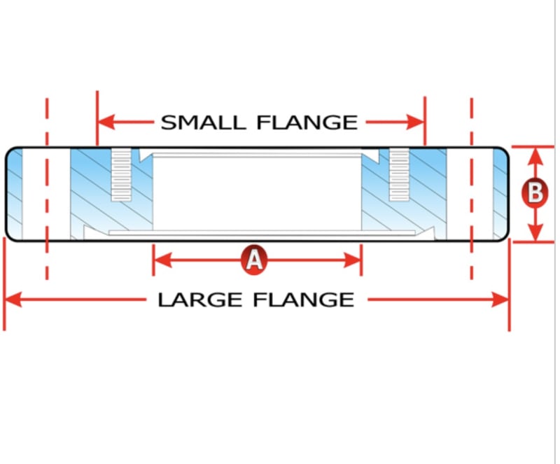

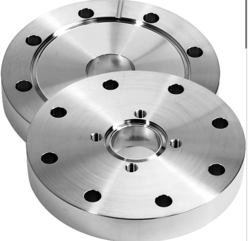

Very similar to this setup. Has a through hole in the middle of the flange and a few blind holes around the through hole. I’m looking into UG-36(a)(2) now as it could possibly apply here and this flange is hydrostatically tested and passed.
Wouldn’t that mean you’d never be able to have an opening in a flange? Quite common to have through holes for connectors and cabling on these flanges. I did question that statement on the other report too, but alas that engineer is no longer working here. Not sure about welded studs, I’d have to ask around on that one.

Devil's in the details. How big are these screw holes? How deep? If they are "few & small" and you can meet UG-43 depth requirements I'd not worry about it.

OP,
SnTMan and GD2 were spot on.
Even though this is for pipe and nozzle necks, it addresses your issue and at least gives you a method of validation.
If you calculate the opening as a diameter that includes the tapped holes you will be fine, then use UG-43(d) and (g) for the tapped hole depth (as others have said).

Look at the following scenario:
1. The flange in the pic is a pressure containing part.
2. There is a through-hole at the center of this flange.
3. There must be a connecting part (not in the pic) which is connected to the flange though 4 screws.
Now here is what will happen:
4. The connected part will have to be pressure part (as it will fall at the pressure boundary).
5. Did you do the bolt/screw sizing for the four screws to take the pressure and gasket seating load?
Draw up another picture and show what is connected through the screws or members to understand clearly where the pressure boundary ends.
With info you provided, the connected part has to be designed as a pressure part.

jt1234,
You are 100% correct and I agree with your thoughts on whether stress analysis and reinforcement analysis are required.
We will need OP to comment further but I do not think those pictures and drawings are what is being discussed in OP's original post.
OP posted the pictures and drawing to show that blind and through holes are common on flanges, to which I agree. OP's flat head flange is using UG-34, which I think would be appropriate based on the description. OP's original question, as I read it, indicated there were blind holes of unknown depth, machined into the external surface of the head flange and where in the BPVC, are holes such as these, discussed, in terms of performing any sort of check.
In the absence of drawings or specific dimensions, it is difficult to determine whether a 1/4" deep 6-32 hole in a 2" thick flange or a 7/8" deep 1/4-20 in a 1" flange are being considered. Without that information it is difficult to speak in any sort of specific terms about what should and shouldn't be checked.
I would not think any sort of stress or reinforcement considerations would be needed since it is for attaching a junction box and the term "not subject to loading" in this sense would be appropriate, but I would not think that the remaining thickness of material, being unknown, can go unaccounted for, in terms of pressure retainment. I would not think hydro would be the appropriate method in determining if the remaining thickness is sufficient. UG-43 does provide a method for determining if the remaining thickness is sufficient. Appendix 30 could also be considered but for studded connections, it too refers back to UG-43. That said, I may have read OP's original post incorrectly and this indeed should be Appendix 2 and in such a case I refer back to jt1234
