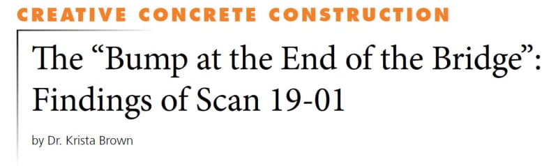

From an ariticle in the Fall 2022, Aspire, Concrete Bridge magazine that might be of interest:
I'll have to see if I can access that report. Settling approach slabs have definitely been one of the most persistent issues for bridge construction, particularly for integral abutment bridges.
