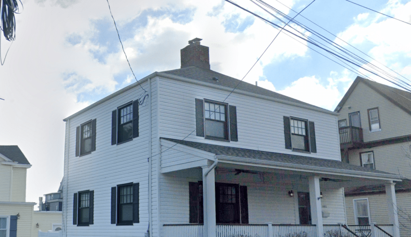

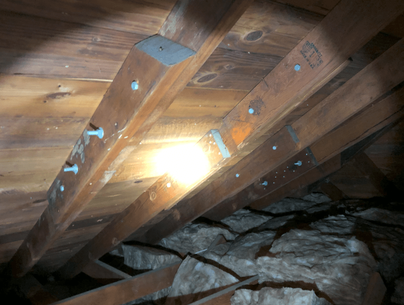

Completed an inspection on a residential hip roof that had five 2x6 roof rafters on each side scabbed with short 2x6 sister members. The original rafters are 16' long but several of them were either spliced with a scab plate or broken at midspan by a scab plate. In a perfect world, I would have them remove the scab members and just sister all 10 rafters with full length 2x6's but there is no way to get 16 foot pieces up there. Any thoughts on making this more secure/reinforced? Each rafter scab had minimal fasteners (two 1/2" diameter thru bolts and some nails, max).

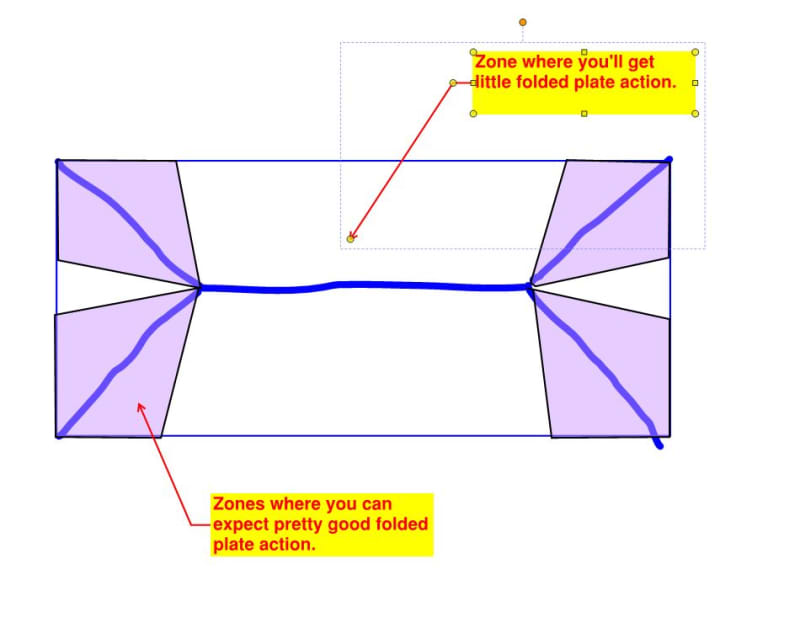

A lot of these old, conventional framed hips wind up working via a combination tied arch behavior and sort of a folded plate shell action that relies on the in plane stiffness of the sheathing. That tends to put your rafters into compression significantly. And your offending splices would actually tend to be quite capable in compression (butt joints).
I'd be inclined to tell the owner that the roof is fine as is but will be quite sensitive to future modifications that might upset the system behavior that makes it work. So any significant alterations should be reviewed by and engineer (new dormers, sheathing removal, etc).
If those splices were getting overloaded in bending, I would expect to see some distress in them such as splitting at the fasteners.

One thing that I like about OP's roof is that the hip is nearly square in plan. Those tend to do well be cause the best folded plate action occurs at the ridge lines as a result of the roof plane geometry. Roof diaphragms on square hips tend to behave almost like a circular shell structure with a tension ring. If the roof were more rectangular in plan, I would be more reluctant to employ such arguments.
