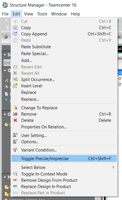

I save an assembly as "precise". Now I regret it. I can't seem to find a way to revert to imprecise. Is there a way?

Answer for TC10, but I think later versions will be the same (or very similar).
In TC, right click on the item rev of your assembly and send to -> structure manager. Select your assembly and go to edit -> toggle precise/imprecise.

Thanks. I missed it the first 30 times I looked! At least now I know it was there, mocking me.
