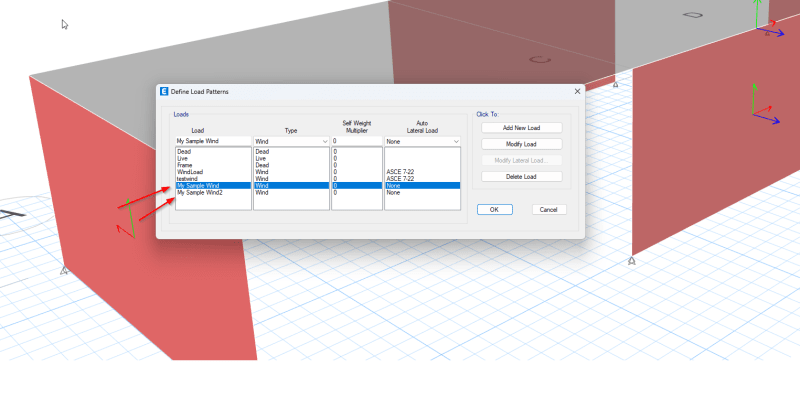

I uploaded the code on github.
Python:
TableKey2 = 'Load Pattern Definitions - Auto Wind - ASCE 7-22'
ret = SapModel.LoadPatterns.Add("My Sample Wind", 6)
ret2 = SapModel.LoadPatterns.Add("My Sample Wind2", 6)
TableVersion = 0
FieldsKeysIncluded = ['Name', 'IsAuto', 'Exposure','TopStory','BotStory','Parapet','ParapetHt','UserCp','UserCpw',
'UserCplx','UserCpwy','UserCply','ASCECase','e1','e2','WindSpeed','ExpType','GrdElevFact','kzt','GustFact','Kd',
'SolidGross', 'Set', 'WidthType', 'Angle', 'Story', 'Diaphragm', 'Width', 'Depth', 'X', 'Y']
NumberRecords = 2
Data = ["My Sample Wind", "No", "Diaphragms", "Story1", "Base", "No", None, "No",
        None, None, None, None, "Create All", "0.15", "0.15", "100", "C", "1", "1", "0.85", "0.85",
        None, None, None, None, None, None, None, None, None, None]
Data2 = ["My Sample Wind2", "No", "Diaphragms", "Story1", "Base", "No", None, "No",
megadata = Data.copy()
megadata.extend(Data2)
MyNewWind = SapModel.DatabaseTables.SetTableForEditingArray(TableKey2,TableVersion,FieldsKeysIncluded, NumberRecords, megadata)
This code adds these two lines into the load patterns.
Edit: I see my error, it didn't take the ASCE 7-22 inputs.

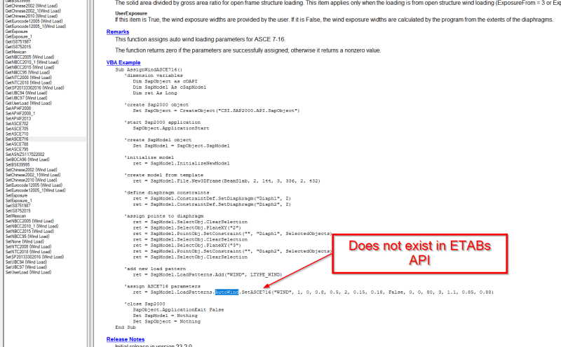

Just a heads up, I've given up on this, I bet it's something they need to come back to. Seems like adding loads based on code updates are bit difficult for the API development team.
I also went to the SAP2000 API and they have different functions available than in the ETABs API.
These SetASCE716 functions are not available in the ETABs API.
