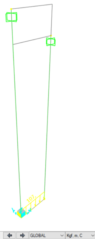

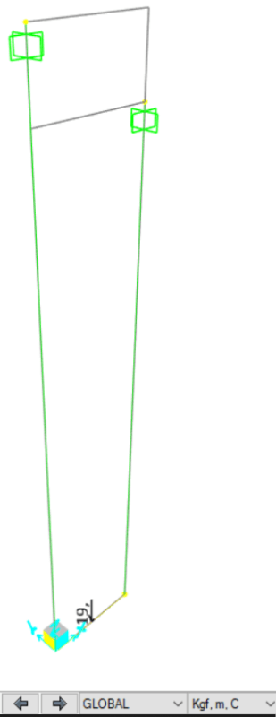

Hi guys,I have troubles moddeling a vertical support with cables. when I chargue the structure with seismic loads Ex (horizontal), Ez (vertical)
the program gives me various modeling warnings, and show me large displacement in the nodes.
How could you avoid being alert?
Operation : RUNNING ANALYSIS
Load Case : Solving Linear Stiffness from Zero (unstressed) initial conditions
THE STRUCTURE IS UNSTABLE OR ILL-CONDITIONED !!. CHECK THE STRUCTURE CAREFULLY FOR. TO OBTAIN FURTHER INFORMATION:. - USE THE STANDARD SOLVER, OR. - RUN AN EIGEN ANALYSIS USING AUTO FREQUENCY SHIFTING (WITH. ADDITIONAL MASS IF NEEDED) AND INVESTIGATE THE MODE SHAPES

Are the nodes at the bottom restrained in the X or Y direction? If not, then the model might be unstable.
Do you have a manual approximation that you can use as a sanity check? Generating one should be fairly straight-forward in this case.
I don't have a handmade calculation, i searched info about pendulum displacement, but i dont find an example with two cables in serie like the structure
You have vertical cables with a lateral load your model is inherently unstable. Cables only resist axial tension.
Mathematically your model appears such that it can experience unrestrained translation and unrestrained rotation in all directions.

You need to come up with appropriate nodal restraints for your analytical model in SAP, it does not appear that you have applied any currently (not clear in the graphics you’ve presented if any nodal restraints/support conditions are applied.)

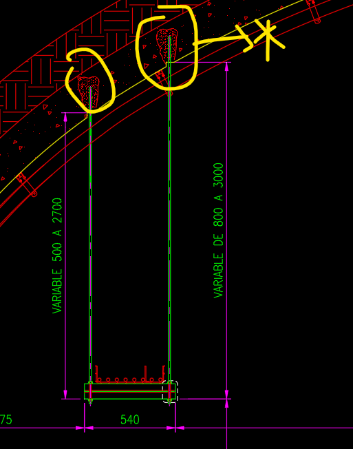

A sketch of the actual structure may be helpful as well.
This is a drawing of the support

I changed the horizontal beam to fixed, but the EI nonzero, i dont know how to changue it in cables.
With these changes, the model does not throw warnings, but it shows displacements of meters.
(I attached the model)

Am I missing something, or is this just two strings (which could be modelled as rods with a stiff-free condition) connected to a beam at each end (making the beam pinned-roller)?
If so, you should be able to determined vertical force and displacement in the string using just the 1D rod formula: EA(d^2u/dx^2) = b , where b=self-weight of string ("cable") per unit length. Boundary conditions would be "EAu(L)=F/2" and "u(x=0) = 0", where "F/2" is half the total vertical load on the beam and "x=0" is displacement at the fixed connection to the arch.
Lateral analysis can be done by assuming that the system consists of three beams with clamped connection to the arch and pinned (hinge, no moment) joints at the vertical-to-horizontal beam junctions. Easy to set up in a FEA program and doable also by hand.
You should not need cables for this model.

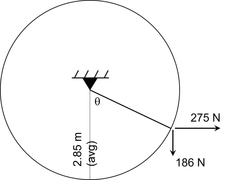

That's the way I see it. I don't think this situation even requires a computerized analysis. The rods are essentially inextensible and the bending stiffness is very low.
I think this is as simple as summing moments around the pin in the following figure, and solve for theta and lateral deflection. When I do that, I get about 2.4 m of lateral deflection. OP, how does that compare to your computerized result?
(Sorry for the figure size. I don't know how to change that.)
What is the basis for the forces (275 N / 186 N)? I think I am missing something.
Edit: Perhaps that comes from the attached file?
If I understand the SAP2000 screenshot units correctly, those are the 28 kgf and 19 kgf forces from the first post.
I just noticed the 107 kgf/m distributed load in the top diagram. I didn't include that in the diagram.
With it included, the method is the same. I get theta = 20.1 deg. and 977 mm lateral deflection.

If I understand it correct I think your approach may be valid as a "sanity check".
But the structure has little horizontal stiffness and the loading is seismic (inertia forces). To start with I think the masses should be modelled at their correct positions. But I can't help wondering how accurate this actualle needs to be. What is the purpose of the analysis? It seems that the OP is more into getting the model to run [smile].
As you have it shown and in your detail this is a vertical support only and offers no lateral restraint without seismic bracing. What exactly are you trying to check or design?
Right. The main purpose is to help verify what's happening in SAP2000. It's easy to get tunnel-vision while trying to make the software work. The static structural analysis of this problem boils down to about two lines of manual calculations.
This design obviously has bigger problems because it has to do with seismic.
Maybe there's lateral stiffness somewhere down the line, as pipe racks tend to have. Like another bay that's braced with seismic cables or something. That wouldn't be captured in this model. As others have noted, I don't think this model is really analyzing anything. I'd design the support to be pin-pinned and calculate the axial forces in the cables.
