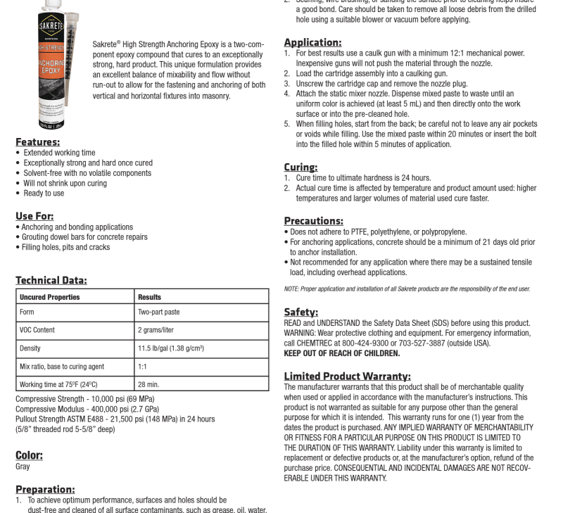

On a recent project, I specified Simpson SET-XP for the anchor bolts. The contractor used the above instead. I am trying to determine if they are reasonably equivalent. I designed the anchor bolts using Simpson Anchor Designer software.
On Sakrete's website, the only indication of structural performance is that it has a 21,500 psi pull-out strength based on ASTM E-488
I can't find any information on Simpson's website regarding this particular test with the Set-XP.
Can anyone offer any guidance?
Thanks!
Cant offer any advice re: comparability since I have no experience with either. But just to put it out there if it's a non-trivial application you can put it on the contractor to proof test via pull-testing as a last result (assuming you're trying to play nice!).
Thanks Enable. Def. trying to play nice so a pullout test may be the way to go.
Unfortunately, this bolts were anchoring a column with a sustained moment due to a cantilever (kinda like a street light). Set-XP is rated for this, Sakrete is not.
If it doesn't have an associated ESR report indicating approval for use with the IBC, I'd tend to reject the substitution.

I would tell them no personally, especially if it has sustained loading. Does Sakrete have ICC approval? Is it cracked concrete approved (assuming some seismic)? Were the anchors installed with special inspection (if sustained tension seems like it should be).
You hate to do it.. but for a constant load scenario as you've described, I'd probably reject this entirely.
Ask if there's an ICC report, a qualification to ACI 355.2-19, or something similar. They've got an ASTM E488 test based pullout strength on there, so they've done at least something. Plus it looks like the product line is only a few years old, so you'd expect they'd do some of the newer certification stuff as part of the initial work on it.

Whoop, wrote the above before I saw the cantilever bit. Yeah, without a standardized report to hang your hat on, and proof of how they were installed I'd run.

This epoxy is non-sag, meaning thixotropic agents were added to make it non-sag. Thixotropic agents, will in most cases come with the benefit adding some reinforcing properties to the paste formula. Much like sand reinforcing large aggregate in concrete. The compressive strength and modulus of this material seems on the low side. You could ask them what category of ASTM-C-881 the epoxy qualifies under.
The image you posted doesn't offer a lot of physical(mechanical) properties, which is a red flag. A heat Deflection Temperature, ASTM-D-648, of at least 120F is the minimum value to be considered a structural epoxy adhesive.
