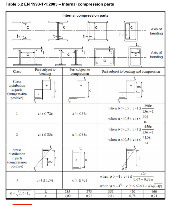

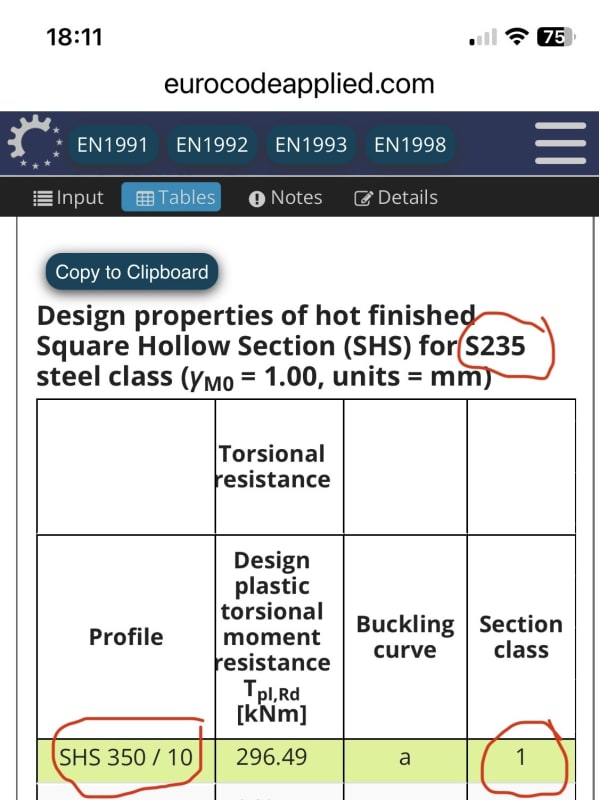

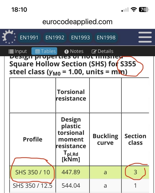

There's an important factor that is the yield stress factor epsilon, that will need to involve the yield strength of the steel. Then use that for classification of the cross section.
Below pictures is examples of the same tube size but one with S355 and one with S235, they are classified as different classes. Though one can be utilized with plastic capacity, or maybe the posibility of forming a plastic hinge, local buckling is important for some situations with section classification.
