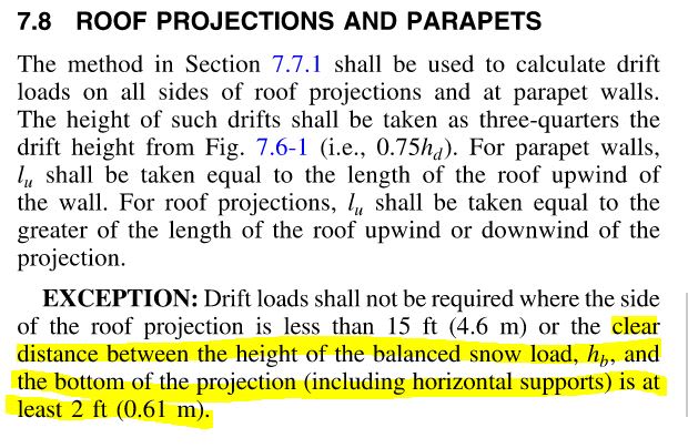

ASCE 7-16 Section 7.8 has this exception:
Note the bottom of the opening has to be 2 ft above the balanced snow load, not the roof itself, so the higher your flat roof snow load, the higher clearance that is required to ignore drift.
