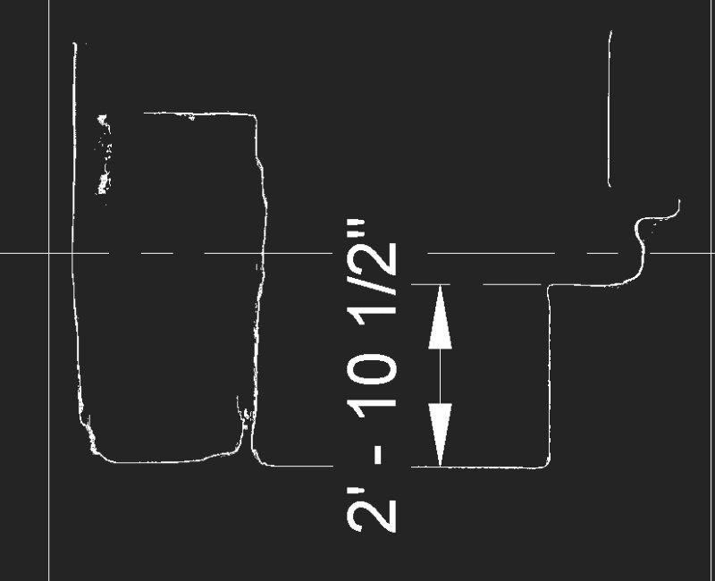

In Revit under the Massing and Site tab model an in place Mass and import the DXF to the Mass
(it needs to be brought into a Mass otherwise floor cut planes and sections won't clip the mesh)
Mesh DXF in Revit:
Section thru counter/floor (actual tape measure 2'- 10 3/4"):

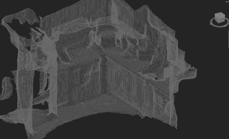

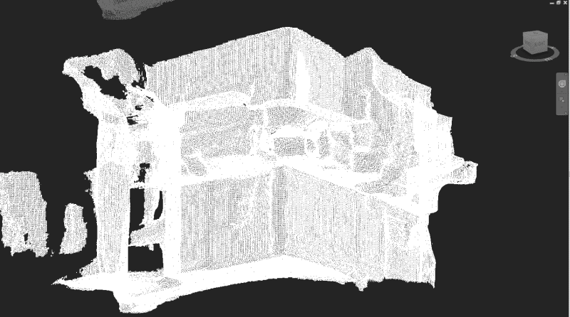

Using the following python code pull out the vertices from the OBJ file and write an .XYZ point cloud file:
Using the Free Trial Version of Autodesk Recap (ability to save project .rcp appears to persist after trial ends) import the .xyz file and index with Recap to a .rcp file (for the app I use to export up is y not z)
Link to Autodesk Recap: Link
In Revit import a point cloud and pick the RCP file.
Point Cloud in Revit:

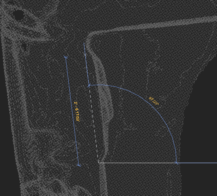

Oven Dimension in Revit (actual 2'- 5 13/16", so again super rough but useful for context)
So not nearly as accurate as those multi thousand dollar scanners but to get a rough scan for context and rough location of obstruction could be pretty useful.
Mesh DXF in Revit:
Path 2:
