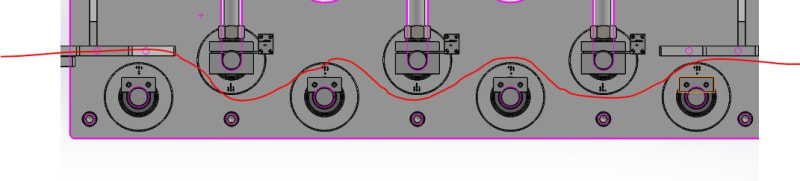

I have a cable that S-shapes under and over a series of pulleys, and I'm trying to calculate how much extra tension is required to pull the rope through the snakey pattern.
In my mind, if the pulleys are frictionless (ie. bearings), then bending the rope around a series of pulleys won't make any difference what-so-ever.
If there is a weight of say 10kg on one end, then surely it's only 10kg force required to pull through.
I want to know if changing the shape so there is more wrap around the pulleys, if it will make any difference to require tension to pull the rope

There looks to be brake calipers on some of the pullies. Are you applying a torque?
can you show the rope path ? just so as we're clear what you mean.
Per-rope means there's no formula. You might get that information from the maker of the selected rope or run your own experiment.

Please see crude sketch of red line showing rope path.
Basically they asked me what force would be required to pull the rope through the snaking pattern, if say a 200kg weight was attached to the other end
At 200 kg presumably vertical mass hanging off the pully system, I think any rope bending "friction" is basically negligible.
In terms of multiple pulleys used on cranes and lifting equipment etc, I can't recall a rope factor in any of them in determining the reduction in force for multiple pulley blocks.
If you need to just add 5% to the pull force o account for this and the starting fiction of the pulleys.
At no rope velocity it is zero extra force. Just can't see it being significant.
Looks like on for testing to me or luck up block and pulley design.
"Basically they asked me what force would be required to pull the rope through the snaking pattern, if say a 200kg weight was attached to the other end" ... none ? the weight a 200kg is (IMHO) certainly more than enough to have that rope moving (at speed) through those blocks. Of course if by "rope" you mean a 8" dia cable then maybe there is a friction/stiffness issue ... what I don't know about ropes and blocks would fill a lot of very big books ...

Let's say we are pulling the rope to the left in the diagram.
The 200kg weight is hanging off the right hand side resisting.
I just wanted to know if the force required would be 200x9.81, or more than that.
Obviously it would be more, but would it be significantly more or not.
My theory was if bearings are "frictionless" then, any snaking pattern would be irrelevant.
Not sure what else I could calculate to get an expected value.
That 1930 Marks Handbook empirical efficiency value looks to be over 90% except for hemp rope over 1-1/2".
With 7 pulleys involved I'd expect 7X "not very much" would total " something" .
But the angle is much less than 180 degrees and there are no sides on the rollers - sheave efficiency. Plus nedders has invented frictionless rollers.
How bad would it be if you give the wrong answer?
I don't see anything in this system that would cause any sort of significant resistance to that rope, provided you're not pulling some thick metal cable.
But you need to be sure? Make a simple test rig.

Actually we do plan to make a test rig.
It's just that my boss wanted me to provide some calculations on what I expect the answer to be prior to this.
In his mind, he expects a huge resistance, which to me seems like a small miracle.
We do intend to test at various cable sizes up to a 64mm metal cable I believe
