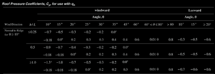

Roof Pressure Coefficients, Cp, for use with qh. (Figure 27.3-1)

Greetings, I am a student researcher and I have a study relating about getting pressure coefficients in gable roof with parapet wall by the use of wind tunnel testing. We already got the pressure data by the use of pressure sensor. Already computed the value of the pressure coefficient in the roof by the use of tributary area. I have a question in the Figure 27.3-1 since we need to plot our data in this tabular form.
Since our statistical treatment is suggested to use a control model without a parapet and we need to correlate our results in that table, why are there two values because we are only getting the highest of the two?

AISC 7-22, see the Commentary for C27.3. You need to clarify are you talking about one positive and one negative pressure or the ones with 2 negative pressures. Either way, it is explained either in note 3 of Figure 27.3-1 or the Commentary
This is what I've found:
"Observations in wind tunnel tests show that areas of very low negative pressure and even slightly positive pressure can occur in all roof structures, particularly as the distance from the windward edge increases and the wind streams reattach to the surface. These pressures can occur even for relatively flat or low-slope roof structures. Experience and judgement from wind-tunnel studies have been used to specify either zero or slightly negative pressures (-0.18) depending on the negative pressure coefficient. These new values require the designer to consider a zero or slightly positive net wind pressure in the load combinations of Section 2."
So the -0.18 is a constant and will change when the roof slope is from 25 to 60 deg and can be 0 when it falls between 60 and 80 deg? In our study, the values we are getting is close to that of the higher value and confused where is the other. Other post I've found dated using ASCE 7-02 stated that it will be like this:

We presented our control which is a no parapet wall gabled roof with h/l ratio of 0.25 and 10 degree slope, the result we are getting by the use of tributary area was ~-0.7. This is done with a wind tunnel testing. Now our study deals with parapet wall and the advisor tasked us to create a table like that but with parapet since it is not in the code. The code have a parapet, and this kind of slope and h/l ratio but with no parapet, but there's nothing in the code with it combined. The advisor said why there are two because that value can govern to. The advisor didn't say it and tasked us to find related literatures on how there are two values that's why I am asking. Thank you for your time in advance.
