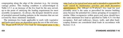

What duration factor would you use for wood beam supporting a roof live load and roof dead load? Based on the definition of a roof live load in ASCE 7-16 chapter 4 section 4.1, it seems to me that it should be 1.25 (construction live load). This is for a residential structure with a sloped roof. Under ASCE 7-16 table 4.3-1 "Roofs" it states that the live load for ordinary flat, pitched, and curved roofs to use 20psf. It also repeats the 20psf for roof areas not intended for occupancy.
