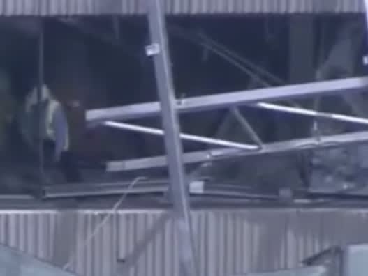

You can see 2 very broken trusses in the video, maybe a failed chord splice?
Well from the video at the top of the linked report, the roof seems to be being held up by five rather weedy looking trusses, two of which have snapped.

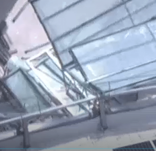

Difficult to see past structural failure of the trusses, but that amount of glass must weigh tonnes
Yeah these glazed roofs are heavy. There’s likely 20+ tonnes of glass in that thing.
Definitely looks like a broken truss chord, probably a splice as noted above, seeing as it’s roughly the quarter point.

...but that amount of glass must weigh tonnes
Glazed roofs are spooky and I always find myself triple-checking thickness of glazing panes, it's exactly the kind of thing that can get bumped up in thickness by a couple of millimetres (for thermal efficiency or something) and end up having an enormous effect on the structure.

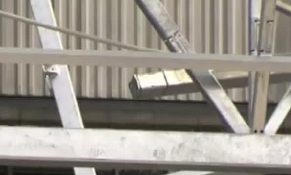

These connections look a bit dodgy.
Slot together trusses?
Looks like a site weld telescopic spigot for a truss chord? I’m guessing designed as fpbw but probably welded like a seal weld because it wasn’t properly detailed with a bevel and 1:1 weld detail etc etc
Wild speculation ofcourse but would explain a sudden failure
Is the truss framing of steel or aluminum? If of aluminum, unless I am mistaken, field welding would have substantially lowered the strength of the material at the weld and would have needed to be accounted for in the design.
Given I can see galvanising holes I'd be guessing steel.
