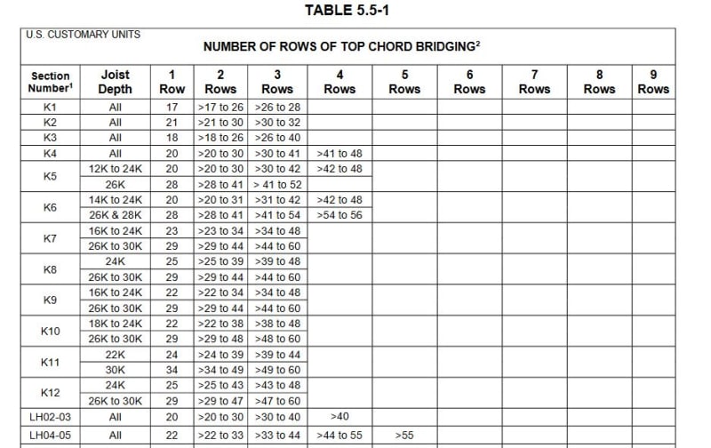

I have encountered ballasted roofs where the ballast is being removed as part of re-roof or has been removed sometime in the past. I have recommended the addition of bottom chord bridging on several of these based on the existing bridging and net uplift magnitude. At a minimum I would recommend adding bridging the the first bottom chord panel point if there is any net uplift at all per SJI specs section 5.11 (assuming K joists)

I am not overly familiar with the specification either, since # rows of bridging is generally left up to the joist supplier. I have seen several ballasted roofs or floor joists with only one row of bridging down the middle, and in glancing briefly at SJI specs more than 1 may not be required for short span joists with gravity load only.. I have never had to dig into this more deeply and maybe I should self-educate when I have some spare time.

I believe SJI has published/will be publishing Tech Digest 2 on the subject of bridging.
