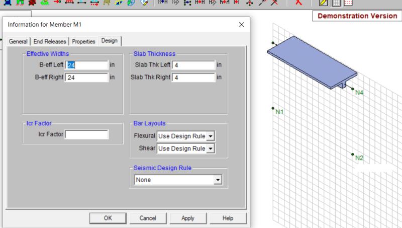

There should be a way to model Tee beams in RISA. This was added some years ago.
Step 1: Draw in your concrete member as a rectangular beam.
Step 2: double click the member to bring up the member properties dialog.
Step 3: on the "Design" tab, enter in the left and right flange thickness and depths.
This treats the Tee beam as a single concrete flexural member. That's what you're looking for, right? Obviously, if you want, you could also model it with plate elements representing the flanges and / or the stem. But, that becomes more complicated and is often less useful.

My RISA window says,
"No information for General Material members here."
Lionel -
That's because you drew it in as a "general material" member not as a concrete member. Those design options are only available for members that are defined with concrete materials.
