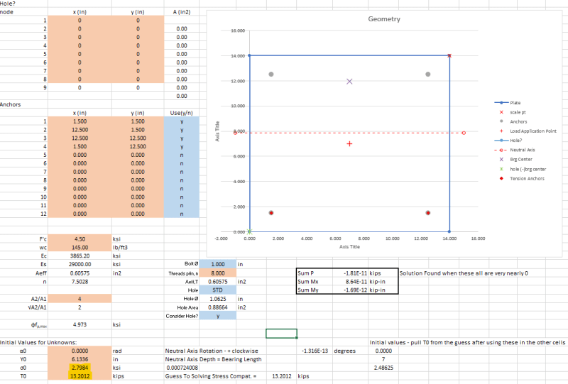

If anyone is interested I've posted the spreadsheet I used for the screenshots here: Link
The spreadsheet makes heavy use of macros so you'll need to enable them for it to function. One thing that the spreadsheet cannot handle is a pure tension case I'm looking into options for that by falling back to just a standard eccentric bolt group analysis.On occasion the default general solution button will pick the wrong solver so I put in (3) buttons below that one for each solver so you can cycle them manually if need be.
Overall the sheet isn't very polished at this point and I've only back checked a handful of cases so would love any feedback from folks that try to use it.

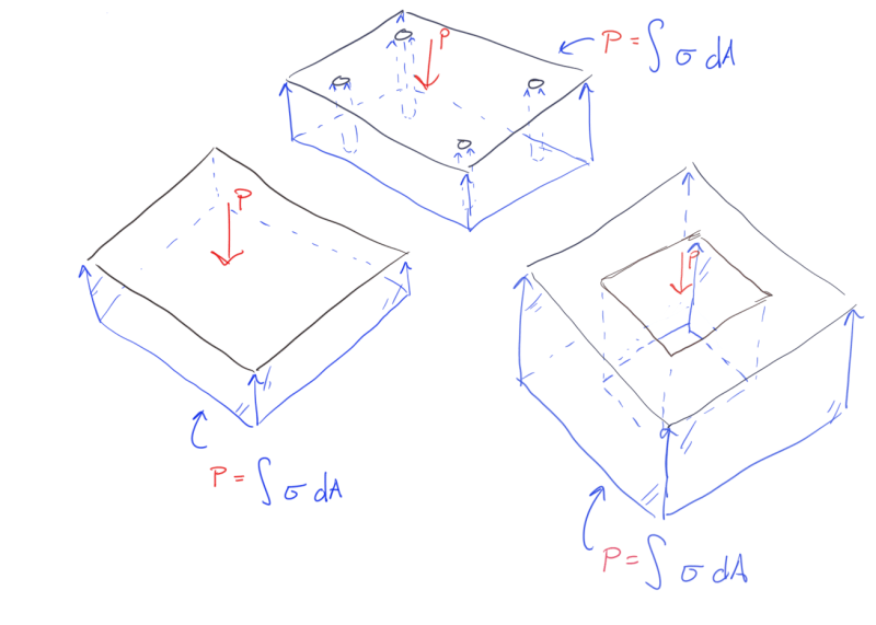

Remove the concrete for a moment and look at a pure axial case, for equilibrium with the applied load the reaction force is just the integral of the bearing stress with respect to the plate area. If there is a hole that area is reduced and thus the resulting required pressure increases. The net result when considering the bolt holes is less than 1/8 ksi for standard 1" bolt holes so for hand design can be likely be ignored without significant impact to the design.

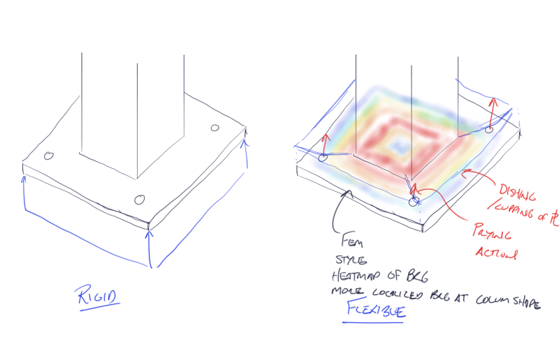

3. Not worried about the concrete more the dishing/cupping and prying action that would come with a flexible plate.
Sure, remove the concrete and the pressure on the plate is higher. The pressure in the concrete is not (assuming you are using ACI or CSA codes). There is no physical way to have bearing pressure control for a steel plate in compression like this. Re: the cupping, no significant cupping can occur before plate yield. I also don't think the prying is possible with any stiffness of plate. Basically, your possible options are a-the plate is stiff enough to distribute the load over the concrete b-the plate is not and concrete crushes below the column. For some fictitious meters wide base plate with a tiny column, I guess elastic deflections could amount to enough to cause the cupping to occur, but this is so far from ordinary practice that you shouldn't be using a design guide.
I disagree the pressure on the concrete surface in those sketches is exactly the same as the pressure reacted by the plate, under the rigid plate assumption. The allowable bearing pressure at the concrete surface is unchanged.

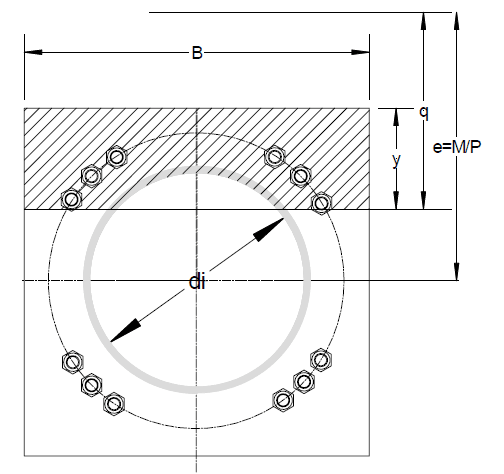

I will elaborate more:
- First you have to calculate moment of inertia of the areas and the moment areas about the “e” line for both the bolts and the concrete area which is under compression.
- The moment of inertia divided by the moment area will then be the location of the neutral axis.
- The process iterates on the value of q until it is determined to a sufficient degree of accuracy.
- Definitions:
modular ratio = n
effective are of bolt = Ab
Abolt = n x Ab
Depth of N.A. = Y
Width of plate = B
Calculating the Area:
Area of the bolt in tension zone, Abolts = Σ n x Ab
Area of concrete in compression zone, Ac = B x Y
Total area = Abolts + Ac
Calculating the Moment of Area:
Moment of Area of concrete, Qc = Area of concrete in compression zone x (q - distance from c.g. of concrete to edge of plate)
Moment of Area of the bolts, Qbolts =
Total moment of Area, Q = Qc + Qbolts
Calculating the Moment of Inertia:
Moment of inertia of the concrete, Ic = moment of inertia of the concrete zone in compression about the line of eccentricity (e)
Moment of inertia of the bolts, Ibolts =
Total moment of Inertia, I = Ic + Ibolts
q = I/Q, then I/Q - q = 0
Where q = e + Y - Depth of the section/2
Since the method of Horn described above calculates the moment of areas and moment of inertia about the eccentricity line, the only variable in this case is the depth of neutral axis, by iterating the value of "Y" you will be able to find an exact solution which takes into account the actual concrete compressive stress and it can be calculated as shown below:
fp = P Y/(q A - Q)
In case of biaxial bending the same method can be used by rotating the section an angle θ so that the N.A. is parallel to the eccentricity line, in this case there will be two variable (The N.A. depth and the angle θ).
The challenge in this case is to create the transformed geometry of the section and to calculate the volume of the bearing pressure, it's basically just a mathematical challenge (if you need more information let me know).

Reference: Design of Monopole Bases, By Daniel Horn, P.E.
Are you able to share the resource that has those equations noted?
I'm trying to back check it by making some assumptions and not getting right answers:
fp - assume the stress block is taken to be rectangular, constant stress over the compression region or do they assume linear stress distribution?
fp - what is A in this equation?
Q,bolts - assume this isn't the signed first moment of area, because if summing moments about the eccentricity line if using the signed first moments Q,bolts+Q,c should = 0 which leads to a div/0 error in your step of q = I/Q.
I,bolts - shouldn't Abolt here also be the transformed area, n*A,bolt
Celt83 said:
fp - assume the stress block is taken to be rectangular, constant stress over the compression region or do the assume linear?
Linear Distribution
Yes, probably this is something I should add to the definition to make things clear.
Abolt = n x Ab, where Ab is the net area of bolt.
They should not be equal.
Qbolts = Σ n x Ab (e - yi)
for case of uniaxial bending:
Qc = Area of bearing pressure (q - Y/2)
thank you for the link.
I see where I was going astray Q,bolts and I,bolts should also include (n-1) components for the bolts within the assumed compression block.
I uploaded a new version of my spreadsheet with Horn's Example 2.4 problem and get close agreement, I only allow 9 coordinates for holes so approximated the opening with points at every 45 degrees.
Link to Sheet Download Page
