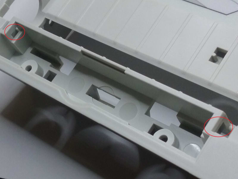

Is there a practical machining method or other process that can uniformly remove about .001”-.005" of material consisting of shut-off flash around the rectangular opening [circled in 1st photo attached]? The opening measures .083 +/-.005" high x .177 +/-.005" wide x .110 +/-.005" deep. The part is injection-molded Sabic NX03583 plastic.

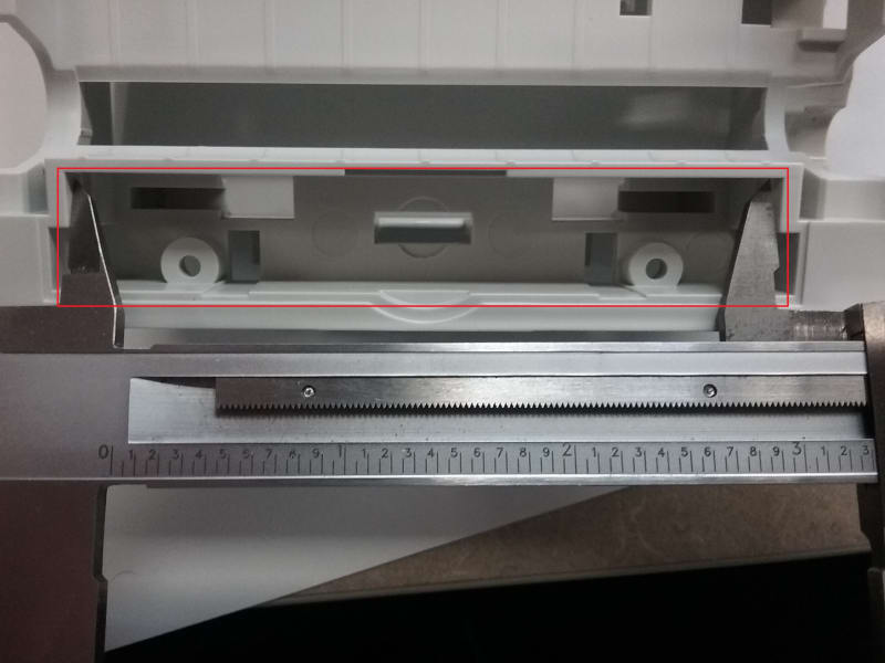

The small rectangle openings 2X are located within a larger rectangular feature, measuring 3.30" length X .50” wide x .55" deep, perpendicular to the 3.30” dimension which makes rework very difficult [See 2nd photo w/ Vernier showing 3.30” distance between each of small rectangle openings].
The mating actuator tab [circled 3rd photo] must clear and move through the small rectangular opening. Current production parts features interfere due to excess flash around the rectangular opening from worn "wipe" shutoff in mold tooling 2X.
Rework method/process and setup must be accurate and repeatable as 2800 parts need to be reworked. The 2800 parts represent safety stock to be molded before production mold is taken offline to fix the openings and other OOS spec features.
*No texture. As-molded non-cosmetic internal surface feature per SPI AQ-103.

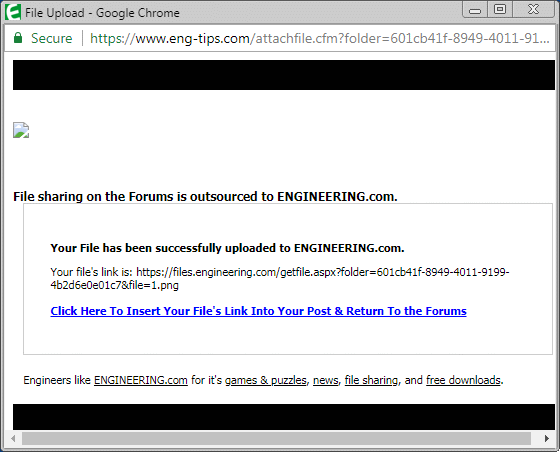

I downloaded files for attachment using window at bottom of 'post' form where it says "Attachment" and "Click Here to upload your file to Engineering.com" at bottom of window (shown below) prior to submitting original thread. I noticed after the fact that no photos appeared or attached. I have not posted in a while and not sure how to attach files.
You didn't follow directions. There's a link that you have to click to insert the uploaded file's URL into the post. The files are not hosted on this site; they're hosted on Engineering.com

See respective photos 1 thru 3 below
Is it on all 4 sides of the opening? Seems to me that something like a dental drill could certainly reach the openings, but alternately, can you rework the mating part instead? What's the fit tolerance required?
TTFN (ta ta for now)
From information I was given, all 4 sides. Dental drill is a good suggestion. Unfortunately RW of mating part in this case will impact mating with 3rd part in assy (not shown). No formal fit specified however affected part database tol. schedule for dimensions 0-.49"= +/-.005".
