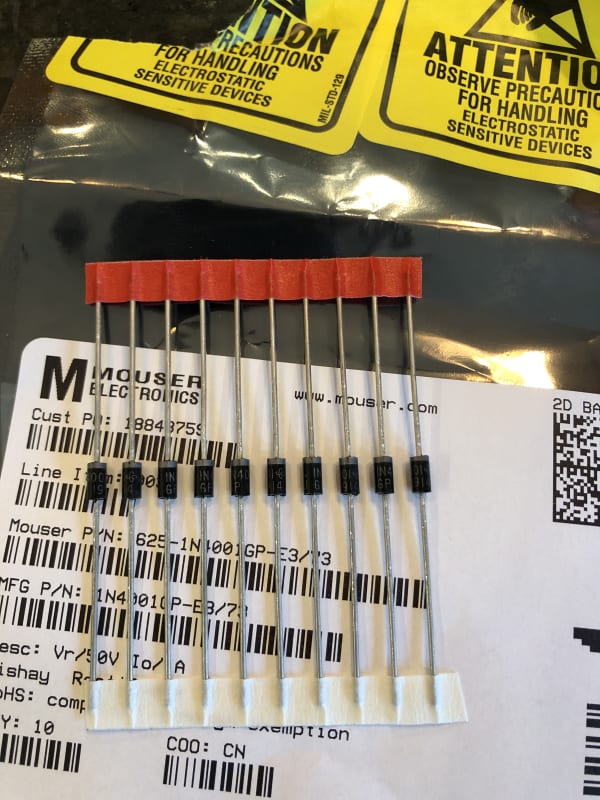

I have a small diffuser driver that I would like to hook up to an Arduino motor shield .
The problem is that this shield can switch polarity on it’s outputs and the diffuser driver will burn out if polarity is switched on its input. So basically if I mess up a small part of the code, the diffuser driver will burn out. Can I connect the positive the diffuser driver to only one of the outputs on the shield then just use a completely different ground. So, if the motor shield decides to switch polarity, it’ll just be going to a pin that has nothing connected to it.
Is this design problematic? If it is, what is another solution to deal with this.
Put a bridge rectifier between the output and the polarity sensitive device, or use an inline diode.

I have some 50V 1A rectifier diodes laying around. Will they work or will I have to order different components? I’m assuming I would just put the rectifier on the negative and only let electricity pass back into the driver. Is that correct?
One diode that may be in either line to prevent reverse polarity from getting to the load.
Use four to make a bridge and your load will accept either polarity.

So the bridge will just take whatever shield pin that’s putting out a positive signal and automatically link it to the positive terminal of the driver then vice versa for the ground? I never knew you could do that. Also the output of the driver is 1.2 amps nominal 3 amps max. Would the bridge be able to handle that?
@IRstuff it should be fine because I’m going to run it at a lower voltage anyways.
I've seen circuits using FETs in this application for very low voltage drops.
Watch this video for some ideas about it: by Jeri Ellsworth "Low Cost Reverse Polarity and Over Current Protection (Corrected)"
3 Amps max?
Will they work? No
Will I have to order different components? Yes

A single diode = -.7 volts
A bridge rectifier = 2 x .7V = 1.4 Volts drop.
Your choice.

OK. I didn’t know if they shared the current or not. I am fine with a voltage drop because as I said I’m going to be running the driver on much lower than 12 V. So, assuming that you recommended that I use a rectifier, you’re saying that the idea I proposed wouldn’t work? The reason I’m so hesitant to order parts because they take a while to ship because of Quarantine.
If I were to buy one, does the voltage rating matter as long as it’s above the voltage that my circuit operates on? I can only find 600 V bridge rectifiers.
The listed voltage is how much they can withstand while blocking current. The actual characteristics are found in the data sheets that are available from most suppliers.
RMS voltage is 420 so I should be good getting that one.
You stated that that your diodes were 1A, which is consistent with its datasheet. Chronic operation at 3A will likely damage them.

Not sure why the voltage is a concern; your motor shield only puts out 12V. You could save a few pennies.
