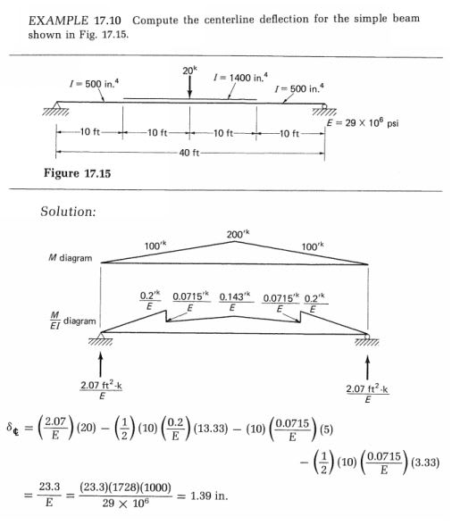

I am looking at finishing out my basement and have a W8 beam that is supported by the exterior concrete wall and (2) pipe columns. The total beam length is only 15', so I'm trying to remove the center pipe column. From a moment and shear strength standpoint, the W8 is still good, but deflection is killing it. I can't sacrifice a ton of headroom, so my first thought is to weld a 6x2 tube steel to the bottom flange. This more than doubles my moment of inertia and gets me to an acceptable deflection.
My main question is: if my concern is the max deflection at midpoint, how much of the 15' span do I need to have the 6x2 tube steel added? My first thought is 2.5' in from each end for a total retrofitted length of 10', but how should I verify this?

If you want to do it with excel it'll be conjugate beam with 3 parts:
part 1: I,w8 alone
part 2: I,w8+hss
part 3: I,w8 alone
The HSS will need to extend beyond the part 1-2 and part 2-3 interface long enough for a weld to develop the Mu,max*Q,hss/I,w8+hss

I'm not sure I'm following you on your spreadsheet approach.
Assuming you will shore up the floors and add the tube to a relatively unloaded beam, the new beam configuration will have different stiffnesses along the length of the beam.
You could perhaps do a moment area analysis of the simple span to arrive at the deflections. The two sections work together so your phrase "whichever section sees the most deflection" doesn't make sense - the sections both are attached and see the same deflection at each point along the span, right?
faq731-376
Here's a Moment Area example for a simple span beam. In your case you'd probably have simply a uniform load:
faq731-376
And here's one where they've added some strengthening to the partial span (like what you are doing):
faq731-376
Ahh, right. That's exactly what I need. Thanks, JAE.
