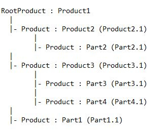

Hello everyone!
I'm trying to automate a process in CATIA v5 using macros.
I have a product with other products or parts underneath it. My goal is to create one folder with root product's part number as name, and in this folder, I'm going to save all parts that are directly under the root product, and for each product, under the root product, I'm going to create another folder in a way similar to the root product.
To help me explain, an example of the product may be this:
In this, the root product is product1, that has product2, product3, and part1 underneath it. So my macro aims to create a folder where part1 will be saved and two more folders will be created (with names product2 and product3). Subsequently, part2 will be saved in product2 folder and part3 and part4 will be saved in product3 folder.
I've managed to create a macro that scrolls down the tree and create when needed the folder. But I have problems to save the files.
In fact, SaveAs property works, as I know, only with document object, and with this macro, I get only products and parts.
I'm new to coding macros but here's the code:

So is there a possibility to get the document from parts and products?
Any help will be very appreciated!
