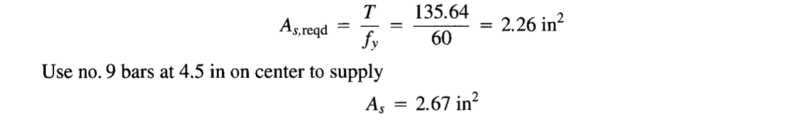

I am reading one article about desigining a concrete retaining wall.
The As required for Stem is As: 2.26 in² per 1 foot.
Author use #9 each 4.5" (Center to Center)
Why AS is equal to 2.67?
As required is 2.26 in², so he should be using 3 #9 (3 in²)each 1 foot.
Any explanation?
Thanks and Regards
(12/4.5) x 1.0 = 2.6.
But I can't tell you why he didn't use #9 @ 5" = 2.40 in^2, greater than required.

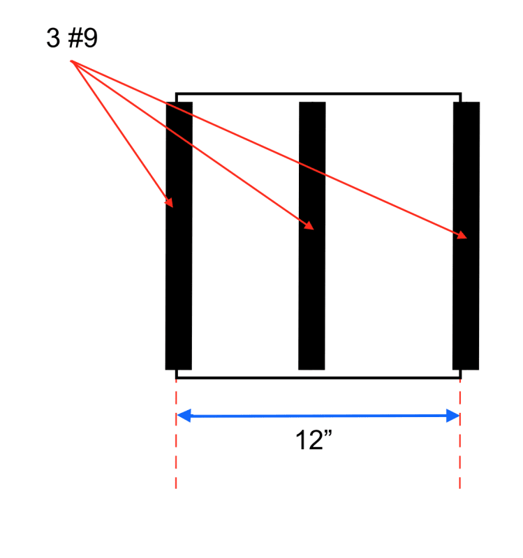

I am confused how to distribute the reinforcement in the stem.
I draw this to show you how I am distributing the reinforcement:
Is this the correct or not the proper way?
The reinforcement is 2.2 in² per 1 foot, so if I use 2 # 9 per 1 foot, the reinforcement area is just 2 x 1 in² = 2 in².
Yes, what you show is, I think, 2 in^2 per foot. That's because your spacing is 6", not the 4.5" as the author suggested, or 5" per my post.
But this spacing is along the length of the wall, not across the width. Not sure what you are dimensioning as 12".
Provide 2#10 @ 6" O.C. will eliminate the confusion. As = 2.54 in2 > 2.26 in2.
OP, try avoid decimal bar spacing, and provide number of bars can be spaced equally in a 12" strip [Bar Space = 12/(#Bars+1) = whole #].
Sometimes the bar spacing in one part of a retaining wall is driven by another part -- e.g. the toe or heel. Constructibility improves when the different spacings are multiples of each other.
just call me Lo.
Or, a 4.5" spacing works out as the actual bar spacing for the wall section's actual length after you subtract the required rebar cover at each end of the wall section.
