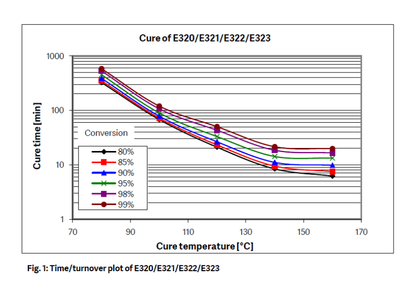

Hi there,
We are building some CFRP boxes with a metal mould. We are using aluminium G.AL® C330 (EN AW 7021 [AlZn5,5Mg1,5] from Gleich Germany) and Prepreg SIGRAPREG® C W205-TW2/2-E323/43%
We cured 3 hours at 120ºC (248F).
The unmoulding wasn't easy. It got stack on the inner walls of the mould.
We used 3 layers of Loctite Frekote 770NC. In the past we used it on a stainles steel mould with a E022 resin without problems
Attached some pictures
What do you think the problem could be? Maybe it was cured too long?
thanks

What about 80°C (175F)? This mould has some mandrels (inner negatives) we used in the past of aluminium 7075 and it was never a problem. Maybe this new, shiny G.AL® C330 (7021) is worse regarding the resin getting stuck?

If we cure at a lower temperature i.e. 80C (175F), clean the mould thoroughly (with Frekote PMC), apply 5 coats of release agent (Frekote 770NC) would it be better?
I don't understand why with the aluminium 7075 we had no problems and now with the G.AL® C330 (7021) we do
