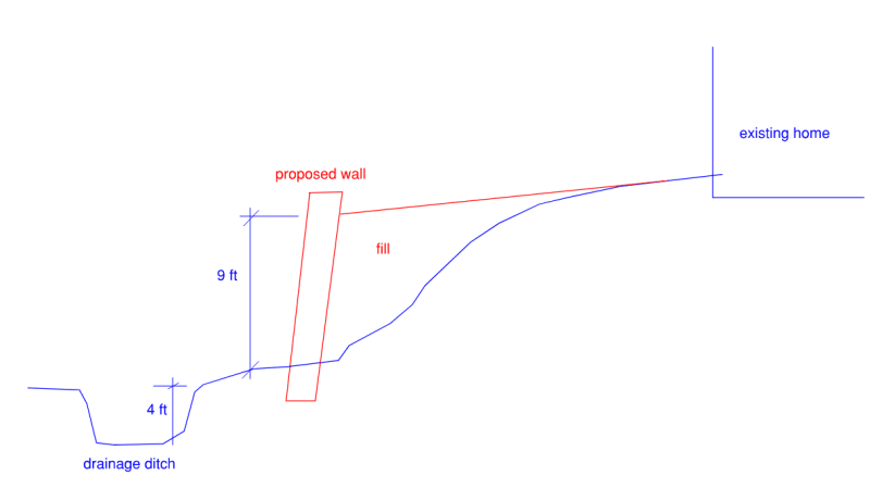

See below a crude sketch of the existing/proposed section. There is some slope at the base of the proposed wall and a "ditch" that looks to stay dry most of the time but has steep eroded banks likely from flow during storm events. Those are what is giving me pause here. No knowledge of groundwater or poor soils but that's not from review of data, just a lack of data.
I would want to run that in a global stability software with ground water at an estimates flood elevation with drawdown, even if the geotech doesn't think it necessary. Having more embedment or an undercut for that case may be necessary.
LOTE - thanks for your input. I think I'm with you, need the global checks to be run.
