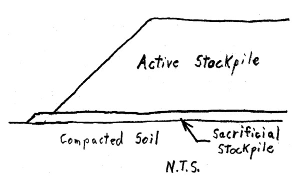

I know nothing about magnesium ore stockpiles, but do have experience with large coal stockpiles at our electric generating stations.
A coal stockpile is not static, material is added and removed continuously. When the stockpile is being used to it's limits (say, during a railroad or mine strike), there must be provisions to keep a mix of soil/coal from being recovered. To do this, we have a significant sacrificial layer of (low grade) coal which is never (intentionally) recovered. This sacrificial layer is, if I remember correctly, about 300 mm thick.
My point is, if a sacrificial layer is used with magnesium ore, perhaps the thickness of this layer could be considered as acceptable settlement. Maybe you can find out.

TO - Sliderule era
I have hinted with same information from our ground improvement vendor stating that maximum settlement (300mm) volume of mineral ore will be consider as sacrificial quantity and even we can convince client by paying back the total volume of mineral ore which is going to settle in future as per design calculation in per cubic meter. Thanks for your valuable suggestion.
