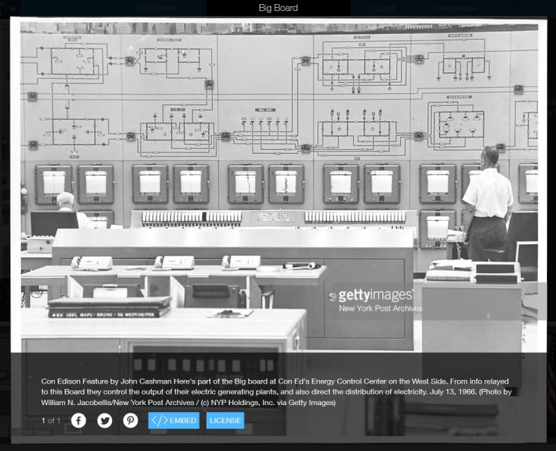

Here is a New Paper picture of the system in 1966- its is about the same today. To the lower middle left is 179th st, the lower middle is Bruckner/Hell Gate, to the middle right is Astoria West at the Top Astoria East at the Bottom.
Today its only two cables from 179th st to Astoria West, One cable via phase angle regulator at 179th to Astoria East.
All of it is a celebration of ring bus, which is VERY popular in the Northern USA. From the rings you have radial cables which may feed up to 5 transformers via disconnects only scattered through out the boroughs.
