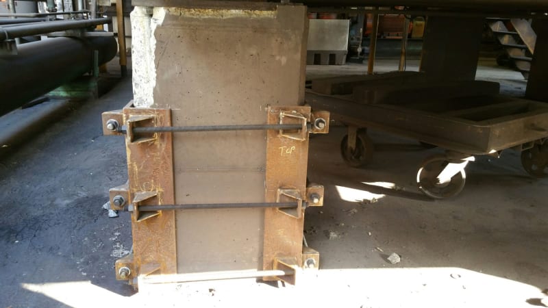

I don't think the jacket philosophy is a bad idea. The spalling occurs because there's no confinement at the top of the column. If you could somewhat shore the condenser bearing point (somehow) and take some load off the column, you could go for a post-tensioned collar approach. It's quite an aggressive approach but I have seen it done.
@a_urbs - Can you elaborate little bit on post-tensioned collar approach? Is it the steel jacketing post-tensioned around the column?
As a_urbs noted the lack of confinement is allowing the spalling. The attached shows a method I've used to provide post-tensioned confinement. In your case, due to the size of the column, extra confinment could be provided with threaded rod through the column, located midway to each face.

a_urbs, what's the concern about needing to reduce gravity load prior to installing that form of collar? Are you worried about overtensioning potentially cracking the column and a potential failure if it's under load? that feels like something you could work around especially since you likely need a pretty nominal tensioning for this specific case.
@TLHS: Just my thought was if you could partially unload the column, install the jacket nice and snug, then reload the column. I feel like you would get better load-sharing as now the additional load will engage the jacket as opposed to trying to tension it under the full loading to get full engagement.
