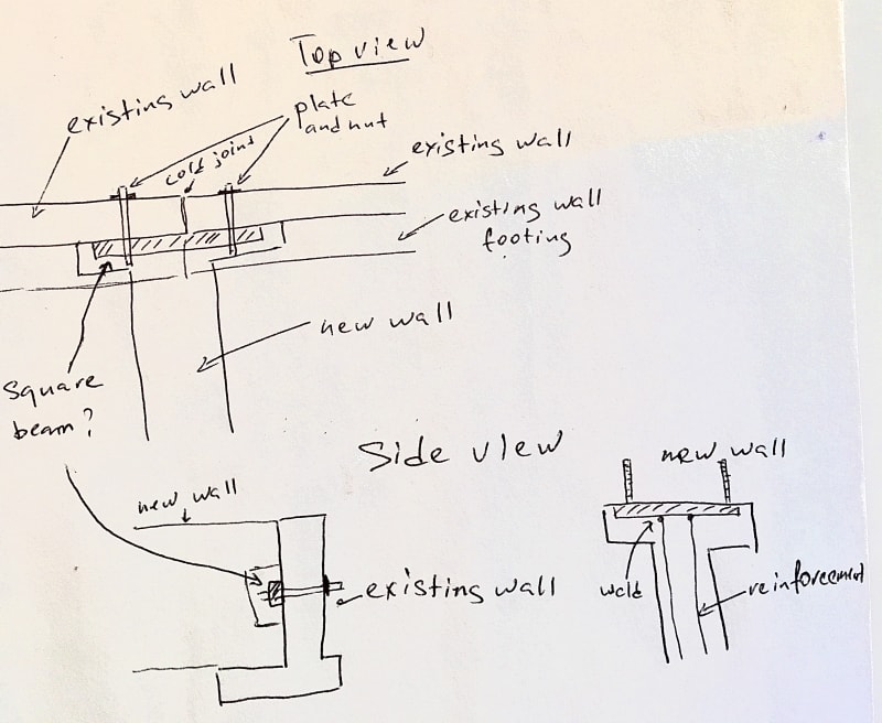

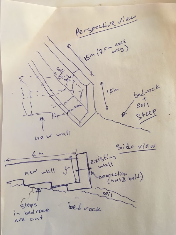

Hello folks. I am not a structural engineer hence seeking an advice from experienced folks out there.
I have an L-shaped concrete retaining wall comprised of two cold joined pieces with large footing. I would like to attach a new perpendicular wall to it which will serve two goals:
1. joining two pieces together
2. fortifying the existing wall preventing it from falling over.
My idea is this new wall will go perpendicular from existing wall step-wise up hill holding the existing wall in place. Now I have a question of how to best attach the new wall to the piece-wise existing wall. So far I came up with this idea:
- get a square beam, drill through it and bolt it through washers to both pieces of the existing wall
- form a T-shaped new concrete wall around it (so its footing will span between both pieces, it will look like an electrical socket plug basically)
- weld the square beam to internal rebars in the newly poured wall
Do you think this is reasonable? Sorry if my explanation is cumbersome, hope a picture can clarify it
