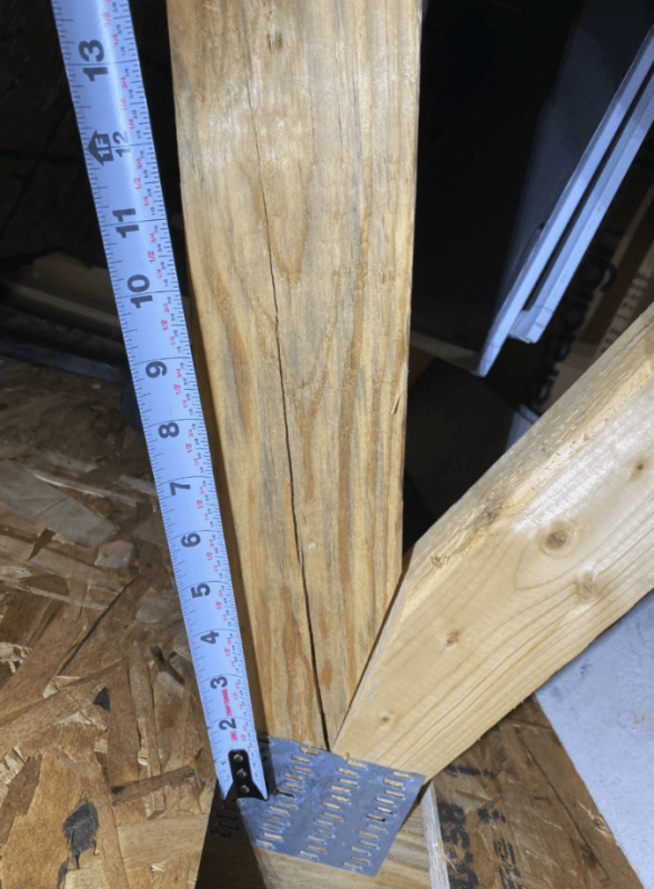

Also, I have discovered that one of the trusses has a split in the W5 web at the bottom, what would be the best way to repair it?
I can take some pics of that later if it would be helpful.

Any idea why the wood split at W5 as you mentioned? Was there a collision at any point? Where is the splinter? Is it close to the gusset plate? Has there been any unplanned loading on this truss in the past?

The walls are wood frame. I have engaged the truss manufacturer to recommend a repair for the split web. As to how it happened, I have no idea. As far as I know there has been no collisions or loading in the past. Here's a pic of the split. [URL unfurl="true"]https://files.engineering.com/getfile.aspx?folder=96cb926f-fb8d-48e9-88b3-5b3195c28171&file=IMG_3555.jpeg[/url]

The split in member W5 is definitely something to be concerned about. It carries a maximum compression of 104# or a maximum tension of 467# and it looks like the crack is headed toward the left edge of the member. If it continues to the edge, the truss loses all of its strength. The location of the crack probably results from shrinkage, together with the positioning of the truss plate. As built, the truss plate engages only half of the member. It would have been better to use a larger truss plate, one which engages all or most of the member.
Member W6 has more compression (246#) but less tension (196#). It has not cracked yet, but it is not very well connected at the bottom. The same condition seems to be true for members W3 and W4.
BA
My old boss would have strangled someone for plate placement like that. Of course he would have killed one of us for designing a joint like that first.
