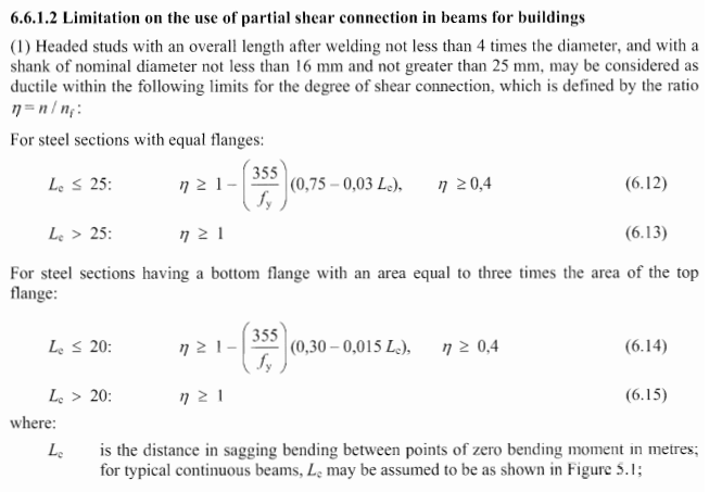

Hello,
I was hired to design a reinforcement for two parallel and equal composite concrete-steel beams. The beams were not designed for the load that they are subject and the deflections are above code limits. The problem that i'm facing is that i checked the quantity of stud bolts and the beam has partial shear connection. I thought of jack up the beam, eliminating the deflection, and weld a plate below to increase the strength and stiffness of the beam, but at the moment i do this, the value of η decreases and the value of the lower limit of η, given by eurocode increases, so i cannot increase the strength and stiffness without affecting the ductility. Does anyone have a suggestion to increase the strength and stiffness of the beam and comply with this code requirement?
PS: Although i'm using the brazilian code, i posted the Eurocode criteria because they are similar and i suppose a lot of people here are familiar with the eurocode.

Just so i could understand, does anyone know why the inferior limit of η increases if the bottom flange area is greater than the top flange?
What difference does it make to the ductility if the same stress must be transmitted from the concrete to the steel?
Just a guess, but considering the shear flow, a large bottom flanges moves the neutral axis downwards, putting more shear through the studs. I'm not sure how much of these equation are analytical or empirical. There is a Commentary on Eurocode 4, but I don't have a copy.

With respect with the reinforcement. I was thinking of reinforcing both flanges because in that way, η inferior limit would not increase.
