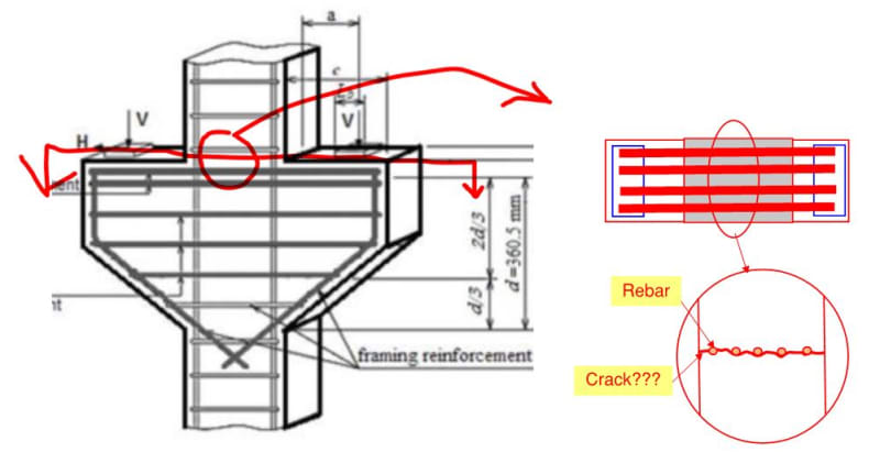

Hello!
Sometimes a lot of reinforcements can be concentrated at a section like precast columns with corbels taking heavy loads.
And then, can concentrated reinforcements cause brittle failure problem as wide continuous disruption surface can reduce
concrete monolithic property?
Can I ignore this problem as long as minimum reinforcement spacing conditions are observed?
Thanks!
-JRW
I'm OK and i would ignore as long as;
- the code specified minimum reinforcement spacing conditions are justified,
- the concrete is poured in horizontal position,( the column formwork with double corbels is at horizontal position and the use of vibration can be done from both sides of crowded area )
My opinion...

You need to provide the minimum required clear bar spacing so that the concrete can flow between the bars.
I would say that you can ignore it for the most part. I've executed designs similar to what you seem to be considering successfully. My experience of precasters is that:
1) The miracle of plant fabrication control make it such that they can manage things that would be questionable for EOR/CIP work.
2) Because a precaster's reputation is intimately tied to the quality of their products, they won't hesitate to "do the right thing" if they find themselves questioning their own ability to pull it off. Many precasters will consider concrete cracking of any kind to represent an undesirable serviceability issue. It's mostly impractical do design to that of course.
I get what you're saying, and it's healthy of you to question this, but I think that this is fine too. Bottom reinforcing in all beams is anchored at the supports in a very similar way that:
3) Is ubiquitous in both precast and CIP work and;
4) Hasn't been causing problems to my knowledge.
