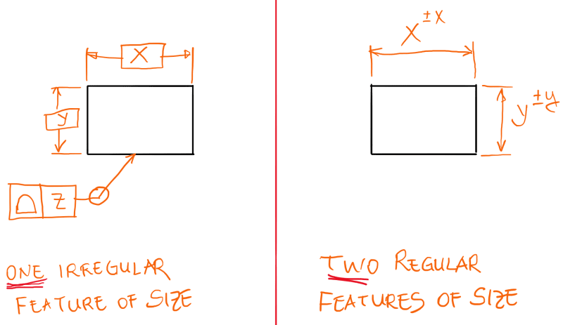

In "The Ultimate GD&T Pocket Guide, 2nd Edition" by Alex Krulikowski, on page 13 there is a table that distinguishes Regular vs Irregular features of size. One distinguishing feature is "May Be Defined With Basic Dimensions and Profile" and it shows No for Regular FOS, and Yes for Irregular FOS. I am having a hard time understanding the meaning of this. Can anyone clarify? Thanks in advance.

Which does not describe directly toleranced dimensions and does have to do with basic dimensions and profile - which may be relevant to an irregular FOS.
supertrucker,
As alluded to above it lies in the wording of the standard's distinction between a directly toleranced dimension utilized for a rFOS (Regular FOS per Y14.5-2009 para 1.2.32.1) and a directly toleranced feature utilized for an iFOS (Irregular FOS per Y14.5-2009 para 1.3.32.2).

I always thought that a FOS had to do with the geometry, but I guess according to the standard, if a have a simple rectangular block, and I use basic dimensions and an all over profile tolerance, the opposing sides of the block are not considered features of size because they are not associated with a directly toleranced dimension. Is this correct?
Another thing worthy of note in the same context:
The only occasion when it matters if a feature is classified as a regular feature of size or irregular feature of size is for the involvement of rule #1. This rule only applies to a regular feature of size. The basically dimensioned and profiled feature on the left side of Tarator's figure doesn't need rule #1, because the limits imposed by the profile tolerance zone require perfect form if the feature is produced entirely at MMC (or entirely at LMC, unlike in the directly toleranced case).
