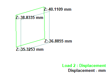

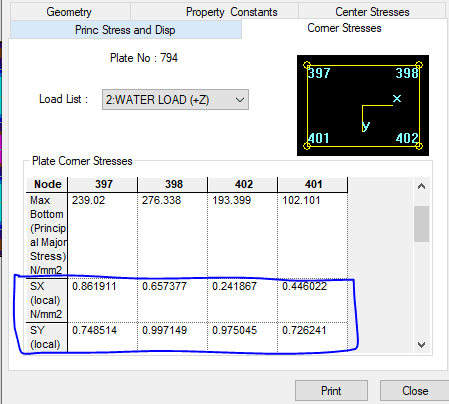

All the joints are rigid and I cannot propose tie rod as it will obstruct the working of tank. I checked the stress distribution in the plate element of STAAD model and found that there is very less membrane stresses in plates. Seems like plate action only there due to which the deflection is high. if there will be some membrane action it will reduce the bulging. Please suggest.
as per my understanding the plate element in STAAD is Hybrid element having Plane stress and bending both action.
As the plates are modelled and supported by steel channels and meshed, the size of Plate element is very small compared to one side of tank and the deflection of plate corner node is relatively small. Might be due to this membrane action is not taking place in STAAD.
Could someone will suggest me the modelling approach such that membrane behaviour will be in action.

From Bentley:
"In STAAD, this (plate) element has both attributes - membrane (in-plane effect) and bending (out-of-plane effect). The bending effect can be shut off by declaring it as ELEMENT PLANE STRESS. The in-plane effect can't be shut off.
