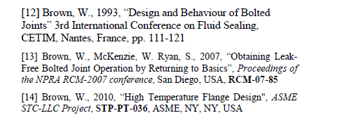

Thanks @TGS4 for directing me to that paper. I could get a copy of the paper PVP2013-97814. I am just summarizing my findings for benefit of others.
The paper recommends to divide the FM factor by 2 if there is concern of sustained piping loads on the joint.
Flange rating per B16.5 / B16.47 considers the effect of high temperature creep. Since the method relies on flange rating it somehow automatically considers high temperature effect but in a very raw and crude fashion.
The paper directs us to the following references for more rigorous calculation of flange joint when assumptions of UG-44(b) are not met.
