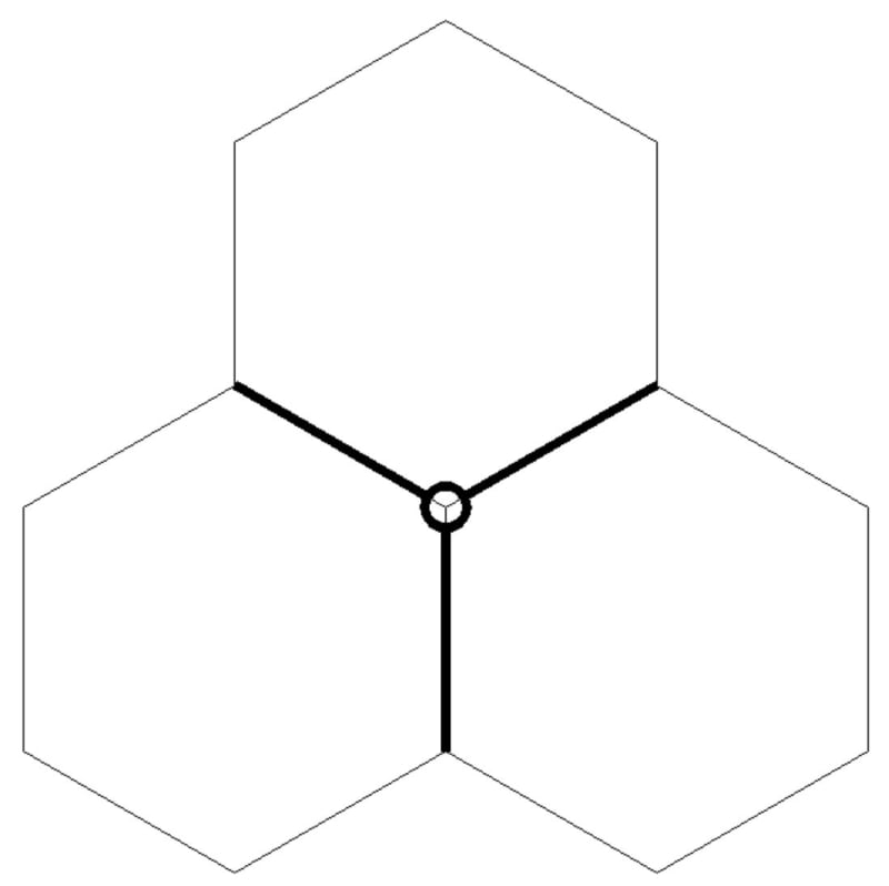

I have a roof structure (image attached). Where can I find information about recommended natural periods of vibration?
The height of the structure is 5m and an approximate radius of 5m. The surface supports glass.
That is mainly a cantilever beam (vertical) with a large mass on the top that will put the beam in bending.
The simplest formula looks like this: for a rough approximation. Since there are diagonal stiffeners, the bending of the beam won't be uniform so it might be taken as if the mass is concentrated at that joint with a separate calculation as if the structure is shortened and bends only about that joint.
However you are likely to see that the broad umbrella resists rotation via inertia and will have an effect that further lowers the natural frequency. There is easily a mode where the umbrella tilts in opposition to the bending, making the beam deflect into an S-shape.
Is this what it looks like in plan?
dik, I think you're missing 3 more diagonal stiffeners coming out of the centre. Looking at orellandres' picture it looks like they're attached to the closest corner of the smallest hexagons (the ones in the centre of the larger hexagons).
Why yes, I do in fact have no idea what I'm talking about
Presumably the required minimum natural frequencies will be related to wind loading requirements and the need to avoid aerodynamic forced displacements and vibrations.
like this?
I was wondering If there is a limit on natural period, my main objective is control it the vibration to avoid problems of service. The structure have a 0.5s of period for first mode, it's a traslational mode.
